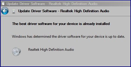

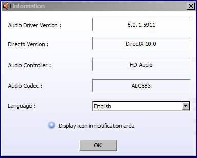

No express here Mate.....with age comes the wisdom[??] to proceed long and slow, and with constant double checks. The 2 day old kid.5911 has been kicked out, and Driver Version 6.0.1.5919 is happily in residence. Tested with a blast with iTunes!
