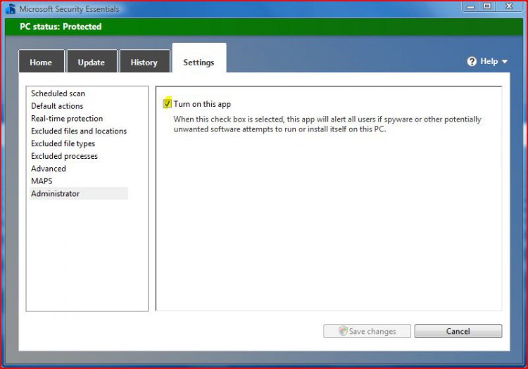

As mentioned previously, MSE 4.9 has a new Administrator setting that makes it simple to disable. Perhaps a picture is worth a thousand words:
There have been numerous reports that this can be done in Safe Mode, and that those suffering from "black screen" are then able to log in normally - meaning they can uninstall MSE normally. I'm not an authority on uninstalling MSE because I never had to do it (my MSE 4.9 upgrade having been successful), but your report seems to suggest that uninstalling MSE in Safe Mode using Iobit is not the best way.

I'll need to look closer at your suggestions with the MSE 4.9 Admin. function and disabling ShellHWDetection service, while in safe mode. I just spent the entire night and morning upgrading Vista so I'm a bit tired as I never got any sleep, since Sunday night. It's currently Tuesday approx. noon, in my time zone.
In safe mode you deselect the Admin. "Turn on this app" essentially turning OFF the Spyware detection of MSE 4.9?

MSE 4.9 Administrator "Turn on this App" option.
After rebooting to Safe Mode I renabled the ShellHWDetection service (automatic).
Then went into MSE 4.9 and enabled the Administrator "Turn on this App" option.
After a reboot to Windows Desktop there was a message MSE was not running. Trying to open MSE produced an error message. I was eventually able to get MSE 4.9 running through the control panel's Security Centers Malware options settings.
I hope this helps some MSE users that are having difficulties running MSE 4.9. The only disadvantage I can see is MSE 4.9 will need to be manually started and the malware enabled sometime after login, through the Security Center. Unless of course someone has come up with some sort of fix or work around.

Another thing to remember when installing MSE 4.9 on a PC with the black screen problem.
If your PC is restarted such as from Windows Update you need to remember to deselect MSE Administrator setting "Turn On this app" as the black screen problem will occur after a reboot if MSE is turned (Turning On MSE enables Virus and Malware monitoring and protection)
I normally use Sleep mode, but may forget about MSE when restarting. If MSE is turned on after restarting you would need to go back into Safe Mode and set MSE to off.

The Admin setting feature of ver. 4.9 is gone under ver. 4.10. Was most likely removed as it's no longer needed.
What I'm satisfied about with ver. 4.10 is I'm now able to login without first going into Safe Mode and turning the Admin setting to off. I would often forget to change the admin setting before a restart, then need to reboot again into safe mode each time to turn the admin setting to off.
