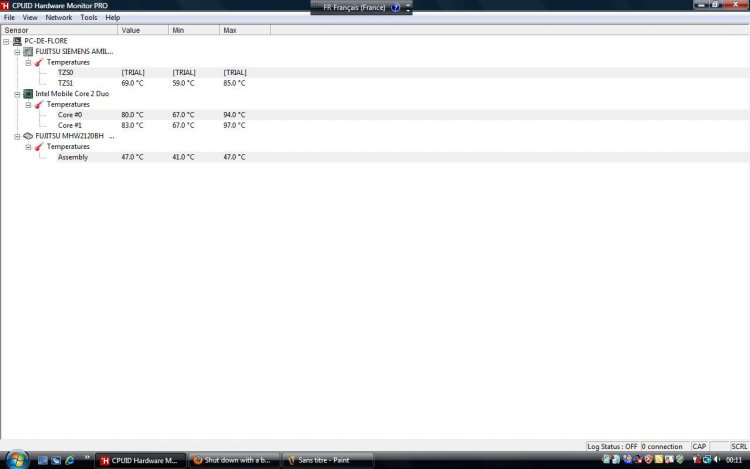

Look at the latest figures from HM Pro:
My room temperature: 25°C

That's clean, but you need to remove the copper piece. But doing so you will need to reset it with thermal compound.
I'm sure yours is like my acer in that removing the heatsink, you'll get lots of dust.
I'm now almost certain you are shutting down due to heat.

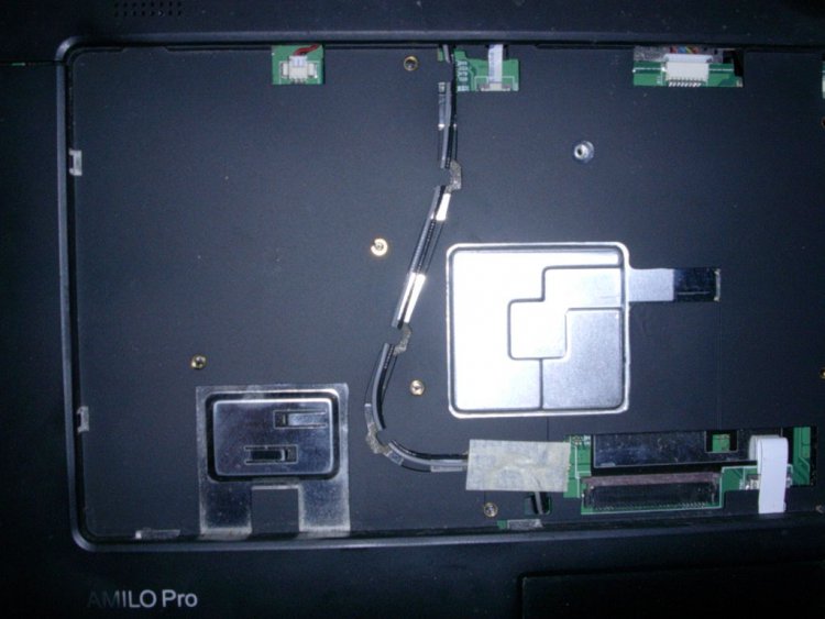

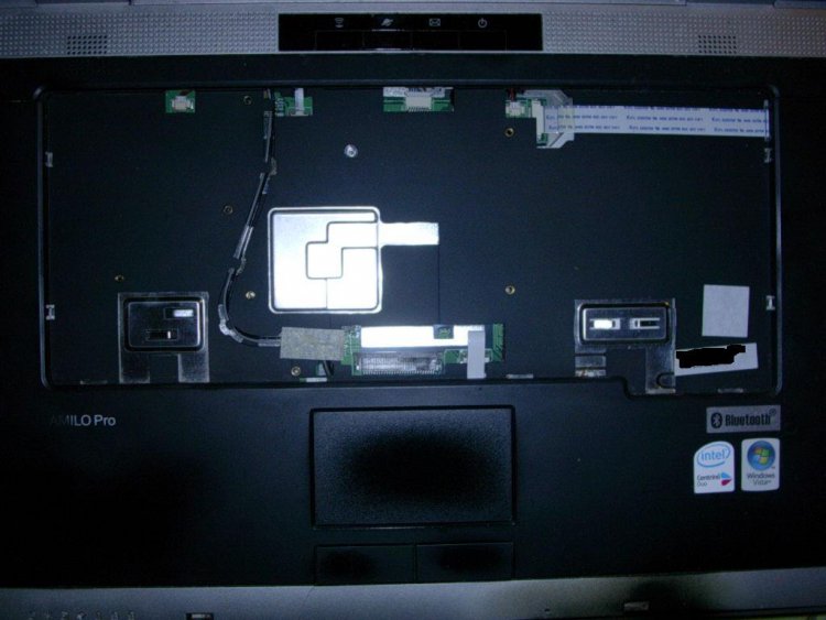

I removed the keyboard but I couldn't remove the black plastic under the keyboard all it's one piece (attached files)
Fan should be located on the left top.
On the back, I think I can remove the heat sink, but I saw that the fan is tightened by an inverted screw (look at previous photos also) and the plastic grid is on the fan. I can't imagine how to remove it.

I think you now need to undo the screws on the bottom of the laptop.

On the two latest pictures from my previous post ? If yes, the head types is cicular and hollow. They are located under the black plastic.

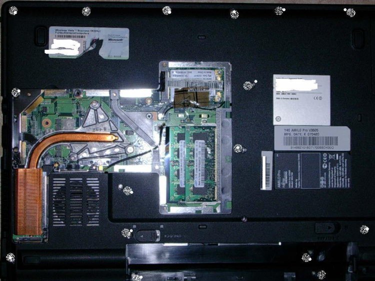

I removed the heat sink and I cleaned the dusty between the vents and the heat sink.
Now, I can run a bootable CD without troubles as I made a test: Full Test Diagnostic Tools during more than 3 hours. The results: all is OK. It tested, Ram Memory, optical disk (CD/DVD Rom), Lan network, modem, Hard Drive, processor.
This was positive things.
The cons, I can't remove the fan to clean it. I don't know exactely which screws were you telling me.

I put white dots where I think thge screws are.

"I put white dots where I think thge screws are." I don't understand Patonb :confused:
The white dots are the screws that I removed.

Yes I believe so.
I linked a german youtube video that showed the person removing all those on a different fujitsu model, but i think the under side looked like yours.

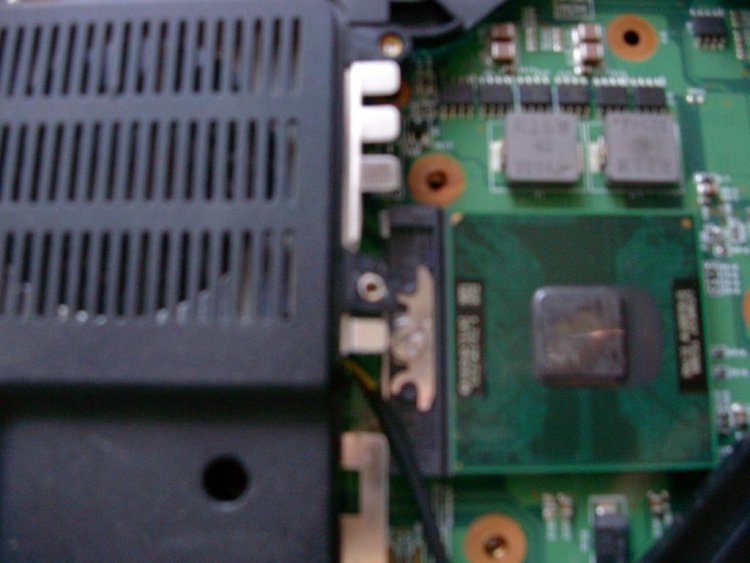

By the way, I didn't find the GPU.
