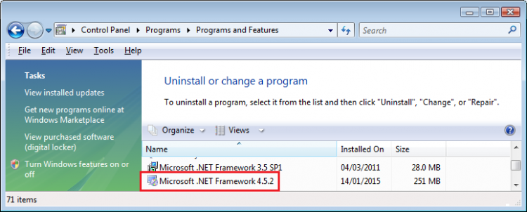

Hi TeknomanSlade:
What MS .NET Framework versions are listed as installed products at Control Panel | Programs | Programs and Features? The .NET Framework v2 won't be listed since it is integrated with Vista and can't be uninstalled from Programs and Features.
I checked the list of affected products at CVE-2017-0160 | .NET Remote Code Execution Vulnerability and the .NET Framework v3.5 for Vista SP2 is not vulnerable to this exploit, although it is on other operating systems. If you don't have .NET Framework v4.5.2 or v4.6 installed I assume that KB4014561 (Description of the Security and Quality Rollup for the .NET Framework 2.0 Service Pack 2 for Windows Vista Service Pack 2 and Windows Server 2008 Service Pack 2: April 11, 2017) would be the correct update.

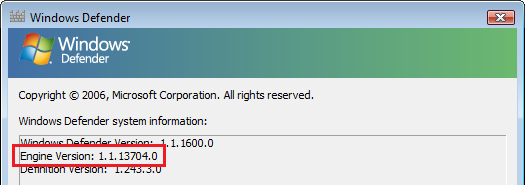

I forgot to add that if you use Windows Defender, the latest definition update [currently Definition Update for Windows Defender - KB915597 (Definition 1.243.3.0)] should patch your scan engine to v1.1.13704.0 and protect you from the critical security vulnerability CVE-2017-0290 discussed in the Woody on Windows article Here's how to check if your PC got Microsoft's fix for Windows Defender bug.
My Norton Security automatically disables Windows Defender at boot-up, but I manually launched Windows Defender this morning and ran another Windows Update and it quickly installed the KB915597 patch for the scan engine. Here's what Help | About Windows Defender now shows on my Vista SP2 machine:

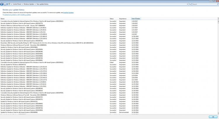

Hello all,
Been busy as of late, and finally got around to checking for Windows Updates.
Checked Windows Update manually, waited for several hours and had no luck with finding updates.
Checked Windows Update History and it appears the last update was in January of 2017.
Was wondering, what would be the most efficient way to catch up with Windows Updates for a Vista64 bit OS?
(February?, March?, April?)
Any suggestions are appreciated.
Here is a screen for the latest Windows Update History
..Checked Windows Update manually, waited for several hours and had no luck with finding updates. Checked Windows Update History and it appears the last update was in January of 2017.
Hi beginner64:
Your screenshot shows that your last few updates installed in January 2017 were actually released in December 2016 (e.g., KB3203621: Cumulative Security Update for Internet Explorer 9: December 13, 2016) so it looks like you're missing your January 2017 updates as well.
Try the step-by-step instructions on page 1 of m#l's thread Updates not working, it has been searching for updates for hours for a possible workaround. Your screenshot shows that the first speed up patch listed in STEP # 2 (KB3205638) was installed on your computer on 23-Dec-2016 but you will likely find that the remaining KB4012583, KB4015195, KB4015380 and KB4014661 speed up patches are still missing and must be pre-installed to speed up Window Update.
Your screenshot doesn't show any recent updates for MS Office 2010, MS Office 2007 or the MS Office Compatibility Pack SP3 but see Note 6 of those instructions if any of these Office-related products are installed since they can also cause these "Checking for updates..." hangs.
Note 6 also mentions a tool called WSUS Offline Update that can be used to install missing security updates for Vista SP2 and other MS products like MS Office. Using this tool is a two-step process - first run UpdateGenerator.exe, select what updates you'd like to install from the interface (options for Vista SP2 are located on the Legacy Products tab) and download the installers; then run UpdateInstaller.exe (located in the Client folder) to finish the installation.
