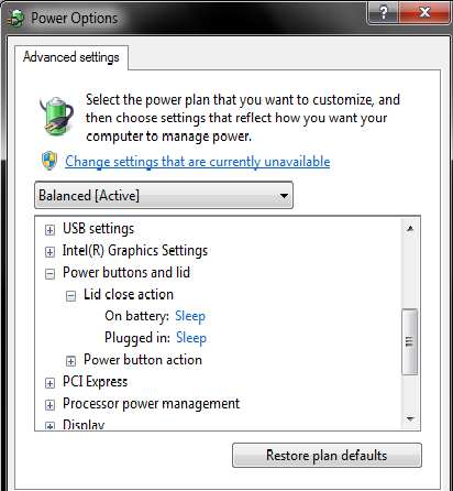

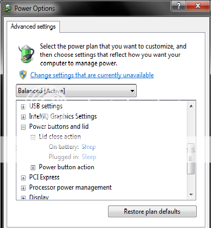

Check Advanced Power Plan Settings
NOTE: Power settings control the computer’s ability to go into and come out of sleep/standby mode.
2. Click on the Power Options icon.​
3. Click on the Change plan settings link under your power plan. (See screenshot below)​
4. Click on Change advanced power settings. (See screenshot below)​
5. Click on Change settings that are currently unavailable. (See screenshots below step 10)​
NOTE: This will allow any Power Options that are grayed out to now work and not be grayed out.​
6. Recommended Settings for Sleep
NOTE: Sleep saves any open documents and programs to memory only, and then puts the computer into a low-power state.
WARNING: If you lose power to the computer, you will also lose what is in memory.​

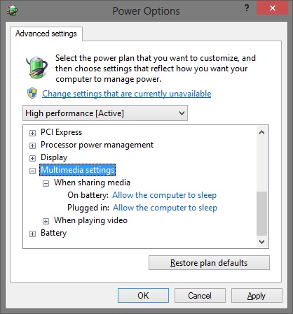

Multimedia settings
[/TD]
[TD]
When sharing media
[/TD]
[TD]
Set to Allow the computer to sleep.
[/TD][/TR][/TABLE]

9. Click on OK to apply​
10. Just exit out the other windows.​
11. Test sleep mode. If it is still not working correctly, then continue to the next step.​

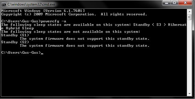

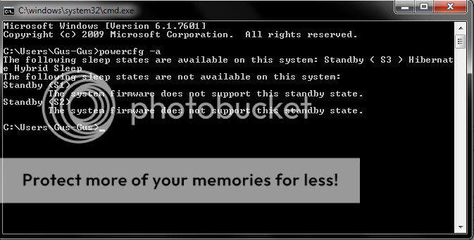

1. Open the Start Menu.​
2. In white line (Start Search) area, type cmd and press Enter.​
3. In command prompt, type powercfg -a and press Enter. (See screenshot below)​
NOTE: This will give you a report of the available sleep states for your computer and will attempt to report reasons why sleep states are unavailable. You will want to see if the ACPI S1 and/or S3 is listed.
4. Restart the computer into the BIOS settings, and go into the Power Management section in the BIOS.​
NOTE: Usually you will press the F2 or Delete key as soon as your computer starts booting to enter the BIOS.
5. Make sure ACPI mode: S3 or S1 is enabled.​
WARNING: S1 (Sleep) and S3 (Hybrid deeper sleep). If you are running an incompatible video card, some or all of these states below may be unavailable. If one of the settings causes your computer to not wake back up afterwards, then reset the CMOS on the motherboard and restart the computer, or unplug the computer for a moment and plug it back in, and reset the BIOS back to the factory default settings.
6. Make sure Wake on Ring and Wake on Lan are disabled.​
NOTE: This will help keep the computer from waking up on its own.​
7. Save the BIOS setting changes and exit to restart the computer.​
8. Test sleep mode. If this does not help, then move on to the next step.​

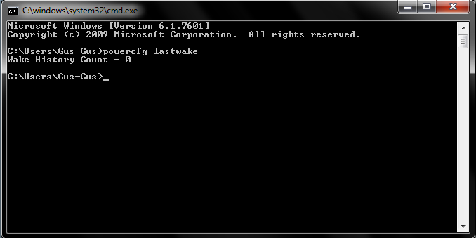

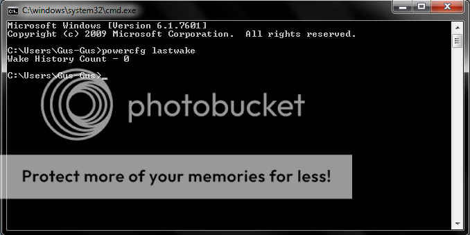

To See what had Waken Up Windows Last
NOTE: This will give you a list of items that woke up the computer last that may help narrow down what is waking up the computer.
3. In command prompt, type powercfg lastwake and press Enter. (See screenshot below)​
NOTE: Notice that I had USB\ROOT\HUB listed. For me, this would be the USB wireless mouse. Your list results will vary of course.​

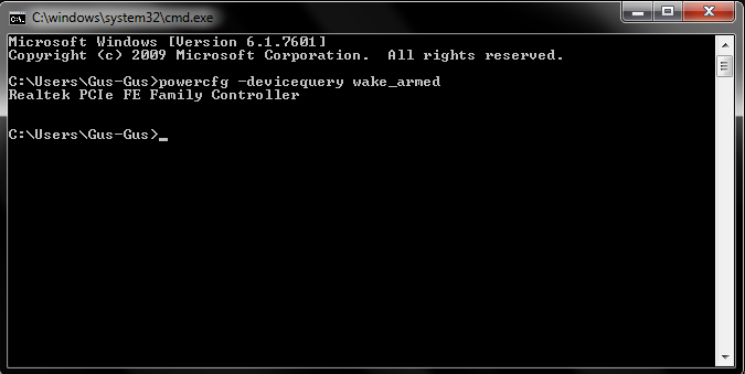

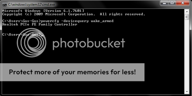

To List, Enable, or Disable Device Names Currently Configured to Wake Up the System From any Sleep State
NOTE: This will show you a list of devices that are able to wake up your computer to help you narrow down a device that may be responsible for waking up your computer. It does not mean that these devices are the ones that woke up your computer though, just that they are able to.
2. To List Devices that Can Wake Up the Computer
A) In the command prompt, copy and paste in bold: (See screenshot below)​
powercfg -devicequery wake_armed and press Enter.​
B) Go through the list of devices to see if you have one you do not want to wake up your system.​
EX: A Network Device (Modem, Ethernet, etc.) or Wireless Mouse.​
C) If you found a device that may be causing the problem, then check with the STEP SIX section below first to see if you can disable a wake up option for the device in it's Power Management settings in Device Manager to test to see if that is it before proceding.​

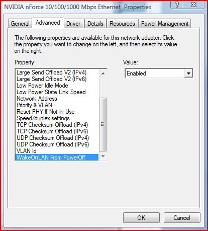

9. Click on the Advanced tab. (See screenshot below)​
NOTE: This is only for the Network device.
10. Check the boxed in red Property: items below to see if they are set to Disabled in the Value: area. (See screenshot above)​
NOTE: This area may be different for your particular network device since it is based on the driver, but it should be similar. You will be looking for any Wake on type property options listed.​
11. Click on OK to apply and close properties window. (See screenshot below step 6 or 9)​

No Luck I'm afraid. I have attached a screenshot of what is available in the advanced options. Unfortunately, when I change any setting, it works once OK (i.e. goes into sleep mode) but then not again so I have to test it twice. The only thing that seems to have worked so far is disabling the device completely, which short of any other suggestions may be my best option.
If you don't use that network adapter, then disabling it would be the easiest option for now.
You're most welcome. At least we know the device causing it now. :)

around 3 days ago my laptop decided to stop going into stand-by mode when i close the lid. Ive gone ahead and restored the system back to when it was working fine and it still didn't help me.
i even checked my Power Options and they seem to be fine as well

Actually it does nothing, it just stays on. That's why i came here, its the first it's done this to me(as in just stay on when closed)
but as you can see i have the power option set on sleep when the lid is closed.
    Toshiba
See if setting your "Multimedia settings" in your power options to "Allow the computer to sleep" like below may help. If not set to this, it may be preventing the PC from sleeping.
