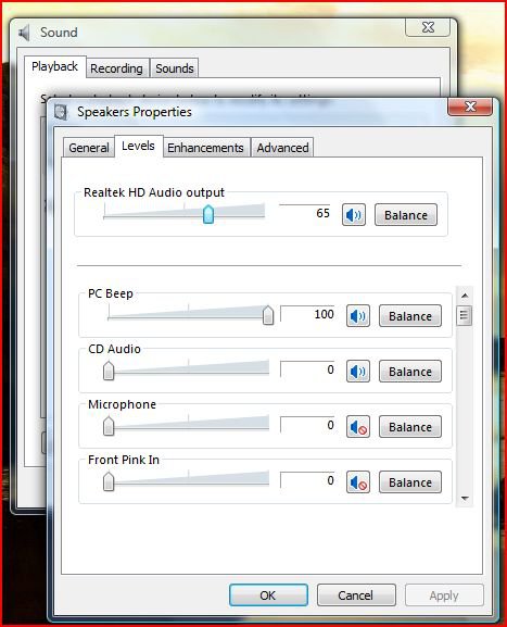

on vista ur MIC is automatically muted by default not to playback..because it was a nuisance..who wants to hear what u say through ur speakers? rather than hear the person ur talkn to..
so to straighten this out right click on ur volume control
in control panel>>>in control panel home>>>click hardware and sound>>>>>>sound>>click on the playback tab>>set speakers as default..and hit properties..click on the levels tab
make sure everything is unmuted...
and set everything that was at 0 to 50..for the sake of this..
main thing is ur mic and pink line in, black line in, etc..
hope this helps...sorry for the kind of confusing directions

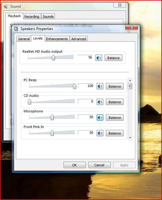

Under the levels tab I don't have all of those levels, I only have "Realtek HD Audio Output" and "PC Beep".

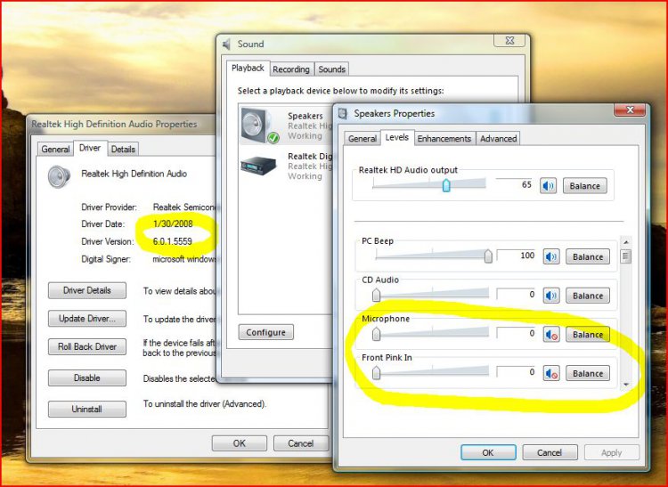

not much of a difference between my new and old drivers..

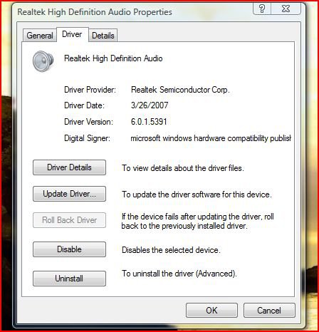

I assume when Toshiba had you update, they had you update through their site. Try getting the Vista drivers for your Realtek here: Realtek
The top option should be the one you want. Install that (set a Windows Restore point before you do). Restart you computer, and then see if those bars have reappeared.
Can someone talk me through how to update the drivers?
Toshiba had me remove the driver and it re-installed it automatically when I restarted my pc.

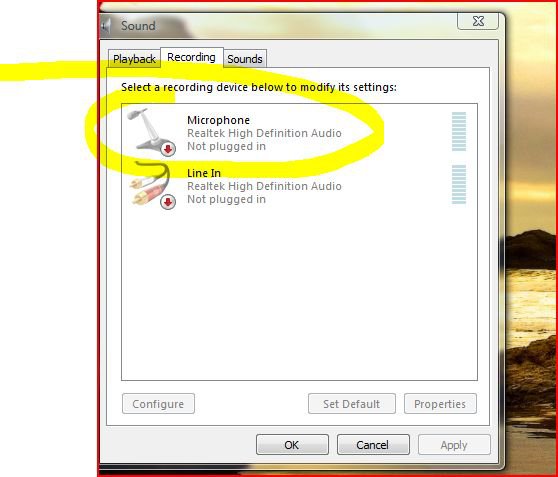

here is the pic of the mic with the green bars that you asked for.
That was exactly what I didn't want to see. Definitely from the same card/drivers. There's something else wonky going on here. Either Toshiba is going to have to cough up a real expert for you, or you'll have to talk to Realtek.

Actually Blood Freak,
you are absolutely correct about the drivers reinstalling itself when u restart..it happened to me too..but those are jus standard vista drivers...once u get there...this is when u unload the realtek package that you downloaded...
