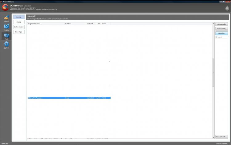

If you are just looking to remove the control panal "Add remove programs icon" then use CCleaner (See snap shot.
Highlight the Java icon & delete the entry!

Ok, I cannot uninstall or reinstall because of the missing msi. ccleaner can't uninstall it either. Yes I ran JavaRa as admin like I have said. There first thing I did was looked for the msi file it is gone that's the problem. Also I have no Java files on my pc since uninstalling it (at least ones I can find like in Program Files) And I will look further into the registry. However I already deleted a lot of Java related registries. And all that contained the version I am pretty sure. I'm starting to contemplate wiping my pc because it will fix better then smashing it with a baseball bat which it deserves.
