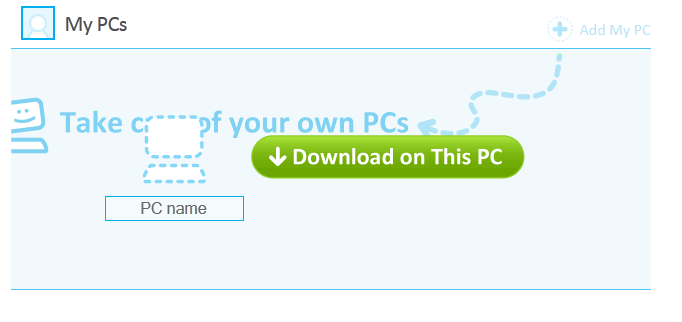

There's nine different Soluto versions to download. Which one would I choose.

If you go to:
http://www.soluto.com
And register an account, you will be presented with this screen, where you can download it:
Once installed, you can track your problems (and hopefully solutions!) online.

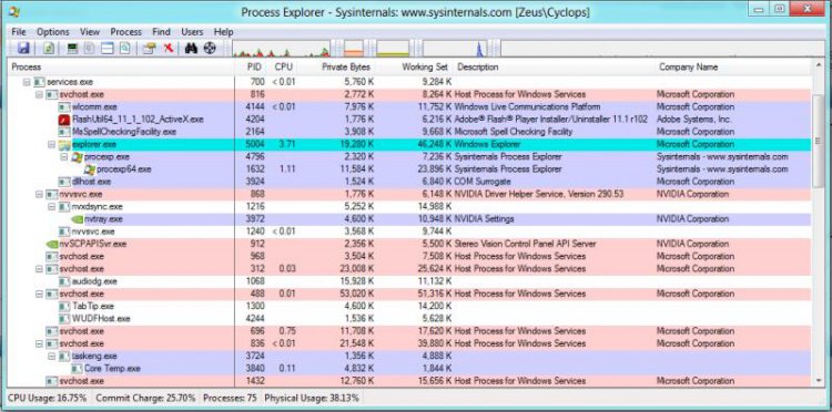

Download and run Process Explorer v15.12
Click on the Process tab to expand it, as shown below. Now, take a look down the CPU column to find out what percentage of CPU time is currently being taken up by the sub-processes under each instance of svchost.exe (as per the highlighted example, showing 3.71). It is quite possible that the sub-process causing the problem will have a high value here.
