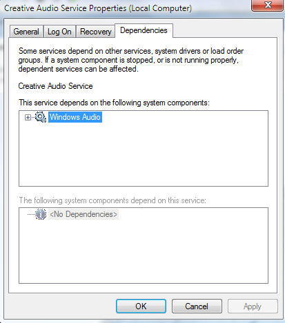

In the last sentece it states dependency.
That means a service it needs to start is not starting.
Go to services again.
Go to the name of your sound card click propties
You will 4 tabs go to dependency and
it will tell you what it depends on.
Just for the sake of it make sure you do not have it muted.
Yes i have done that.:eek:
Also make sure your wires are in the right holes.
Done that too.:eek:
Another idea is to go to device manger and remove the driver
reboot and windows will see the sound card and install new drivers.
You can leave it or go the the manfacture website and get new ones.

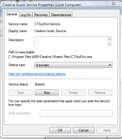

Sending a few shots of what to look for in services.
Hope I was some help.
Jimmy
