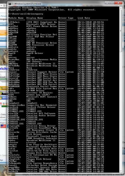

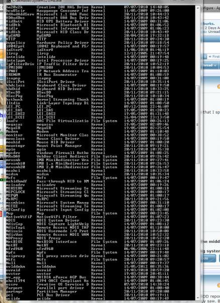

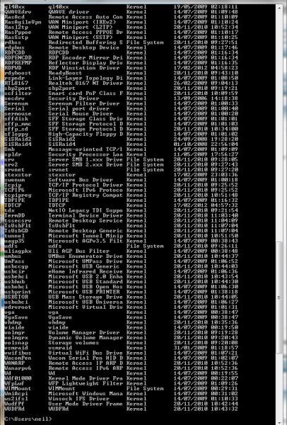

Test yourself,
Go to search, by startbutton and type cmd
in CMD type driverquery and then hit enter. Do you see any Norton Drivers or the one that I specifically mentioned?
Oops, I checked the reports again. The last report you gave me did not have a new BSOD report, I inadvertenlty picked up the last report as new and it was the same one that I previously saw. Bottom line, I have no new information.
here are the results i cant see any symantec drivers

If you read my last post, I may have given faulty information. Run the computer, again, and when it BSODs get the reports. The last BSOD had no new reports.
