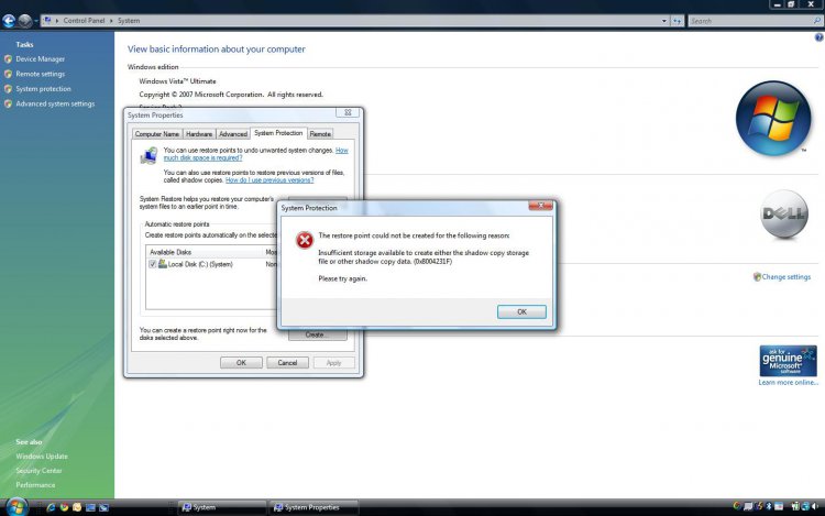

Dell Vista X32 Won't hibernate, sleep, shut down when lid is closed
Just tried it after clean boot. Still nothing- same error message.

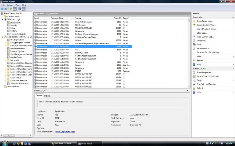

Is this what you were referring to in the even viewer?

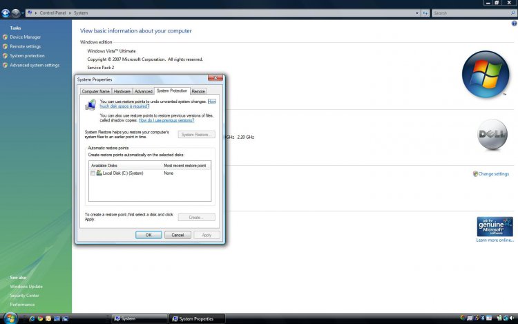

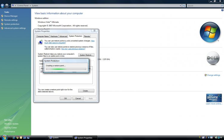

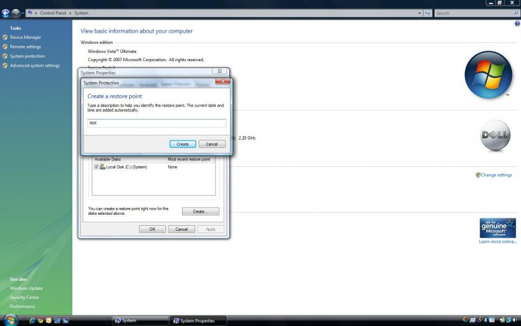

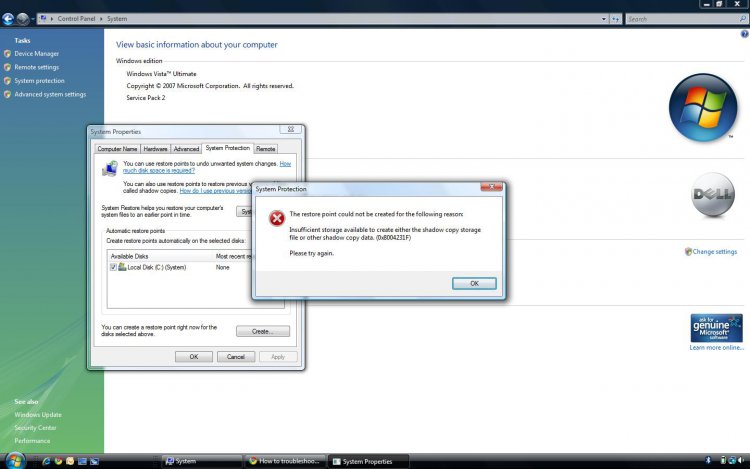

Ok, I reset it- I turned SR off, rebooted, turned it back on, and attempted.
Also, SR only 'sees' C - it doesn't see D or E. I don't remember if that's always been the case, or if that's part of the problem. Results are attached.
THANKS again for your help, patience, and persistence!!!

I am sure that you checked the box for C
If you did, lets go further back than square one.
Download and run malwarebytes at full scan and after updated
Run a full anti virus scan.
I dont really think that this will lead anywhere, but everything else seems to be set correctly.
Try this too, increase the space available for restore. What you are backing up may be too large for the space that you have set aside.

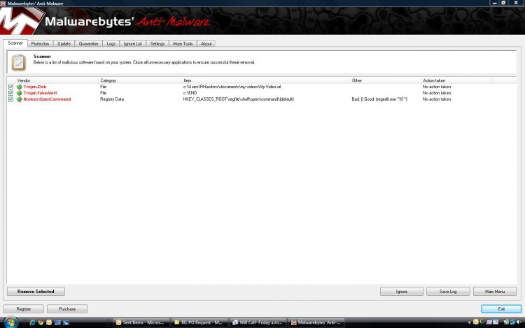

I ran the malwarebytes and have a screenie of what it found. The last one I'm not sure what it is/was.
I'm waiting on trend micro to do a scan, and will follow up with windows defender.
Also, I increased from 30gb to 50, and then 100gb, and it still wouldn't create a restore point.

I will get help, trojans are not good.
After our security people remove the trojan. I will continue to help you. Hopefully this may be the cause of the Restore problem
Glad that we found it. One seems to be involved with registry; not good.

The way things turned out, it was actually a good thing that you had problems with the System R. We may have not discovered this Malware and you may have had bigger problems down the road.
AMEN! I could only imagine how the frustration of dealing with my laptop would've been the least worrisome aspect!!!!!

Trust me when I tell you this. I got you one of the best to help. You will rid of this problem and be like new, again.
Look how awful this thing is
Rootkit - Wikipedia, the free encyclopedia
And these so called people that create these things, disable System Restore because they know that they can be removed if restore works. I think once this is solved, with a few adjustments you will be up and running like new
Because your computer has been badly compromised, You need to change all your passwords using a known 'clean' computer, not this one. If you have any critical information on this computer, Banking and credit card institutions should be notified of the possible security breech.
If you haven't rebooted, please do so, then ..
Rescan with combofix, following my instructions above. Post both HJT and CF logs for me to review.

Also, I tried everything all over again in regards to SR- turned off, rebooted, turned it on and tried to create a point. No dice.
    Dell XPS M1530
    Intel Core 2 Duo T7500 2.2GHz
    3G
    Nvidia GeForce 8600M GT
    Sigma Tel High Def
    Generic PnP
Im pretty sure that you will not get that SR working until the Virus is gone. I think that the Virus shuts off SR to make it more difficult to remove.
You dont want points,now, anyway that will be infected. If you ever restored with one, the virus would be back.
