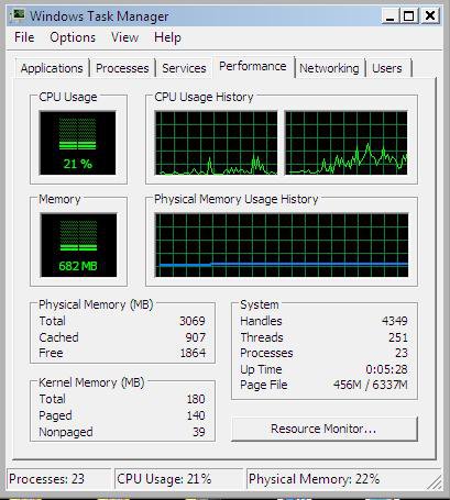

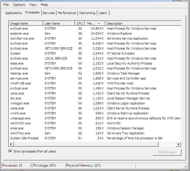

These are 2 screenshots from running in safe mode. Safe mode was an absolute joy to use. Its so nice to have things work exactly when you ask them to work. In short it was rapid! Photoshop CS3 didnt even dent the RAM usage or anything and it loaded in under 6 seconds.
These shots were taken with nothing running at all and were taken right after startup. I'm sure you will notice the big difference lol

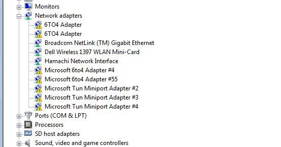

Safe mode has shown us that some program or driver is slowing things up.
Go to search, type "device manager"; inside device manager look for any yellow warning markers. I doubt if you will find any. If you do not, we should focus on that clean boot.

In device manager these were the only issues that i found.
