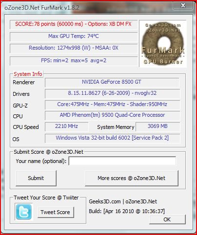

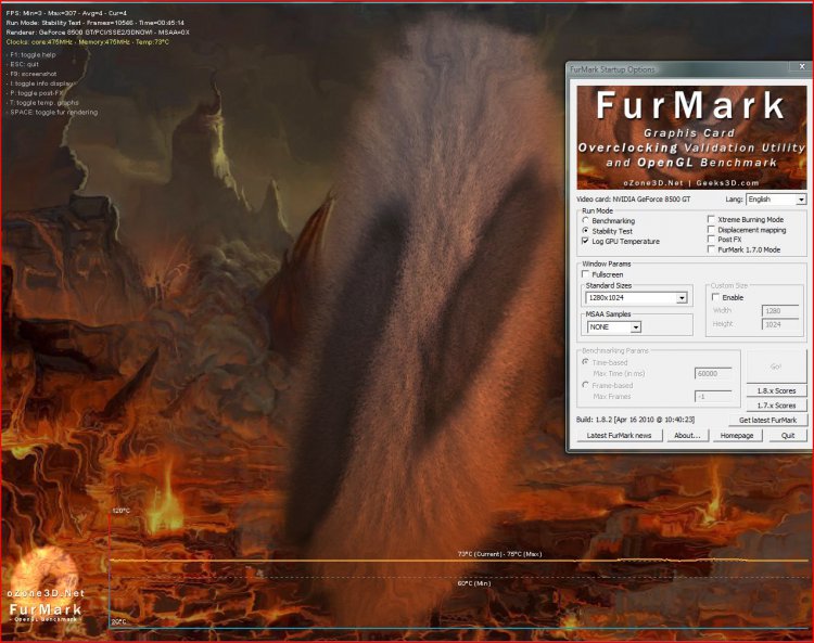

Not heat, here are the results of the FurMark tests (in jpg). Both the Benchmark and the Stress test.

Anything helpful in those images I posted?

If it does not crash, your ok.
Did you do it properly
