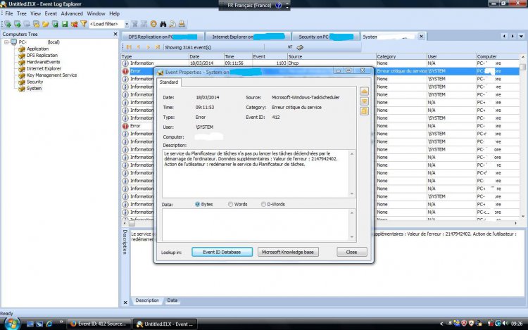

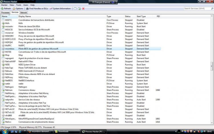

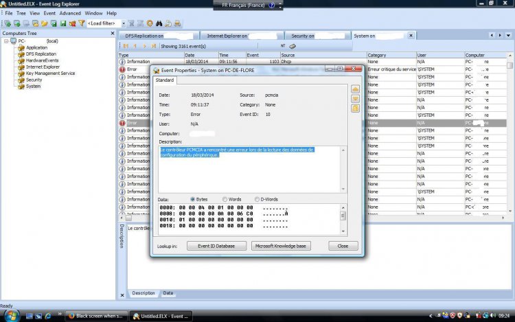

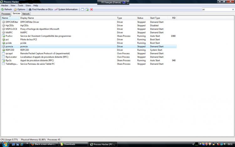

Could you please check the following error that corresponding to pcmcia and Task Scheduler, please ?
About 'Pcmcia not bootstart' jpg file, I couldn't start this device neither set up to a boot start. That's bizarre !
On the contrary, on the Device Manager, I don't have any error.
About Task Scheduler, I don't know what's is concerning ?
About mssmbios.sys ? What do you think ? Should I set up to bootstart ?

@Ashanta - the error for Task Scheduler is a standard 'file not found' error - but I'm not sure which file wasn't found.
Event ID 412 ? Task Scheduler Service Status applies - but is about as useful as a chocolate teapot :(
If you run (in an Elevated Command Prompt)
SC QC Schedule
SC QUERYEX Schedule
SC START Schedule
SC QUERYEX Schedule
what output do you get?
Here are some instructions to make life easier :)
1) To open an Elevated Command Prompt Window (the ECP window), click on Start, All Programs, Accessories – then right-click on Command Prompt, and select Run as Administrator. Accept the UAC prompt.
2) To run the commands easier, highlight the block of commands, and right-click on the highlight – select Copy. In the CP Window, click on the black/white icon at top left – select Paste. The commands will run but may not complete the last command, so hit the Enter Key once.
3) To copy the results... click on the Black/White icon in the top left, and select Edit... 'Select All', and hit the Enter key - then use Ctrl+V or r-click+Paste to paste it into your response.

I got side-tracked :(
There's nothing wrong with the Command Prompt output - it's normal.
It probably means that there's a task set to run at some point, but the target executable for the task is missing.
You need to open Task Scheduler and look through the scheduled tasks, and see if you can find out which one it is that's causing the problem - it could simply be the remains of a piece of malware.
Your ADWCleaner output shows the usual PUPs - have you run MalwareBytes to see what it finds and removes?

Yesterday, I installed and ran a new program to detect hardware problems lik PC-Wizard from the same author of CPU-Z.
PC-Wizard CPUID - System & hardware benchmark, monitoring, reporting
I ran a few system benchmarks and today, I noticed that the time clock is not more syncronized. This is the first time, it's occurred for me. I don't know if it's related to this program or not. Anyway, I couldn't synchronize the time from now.
