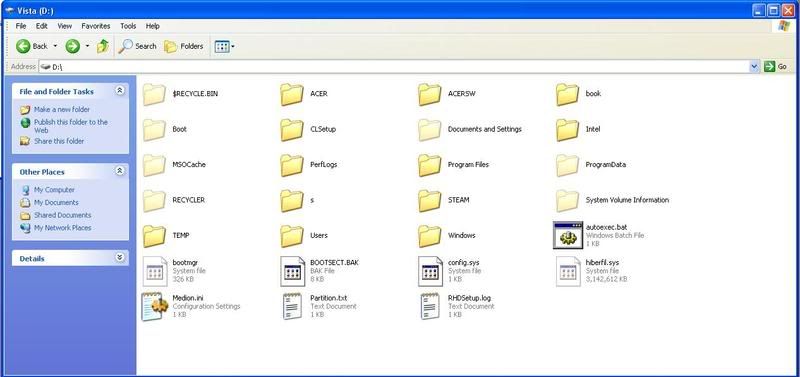

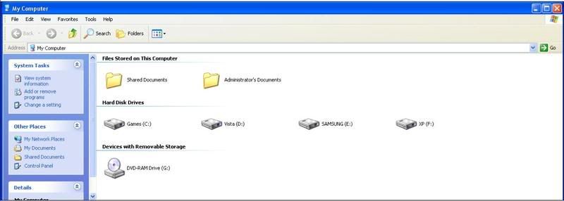

\ If you can browse the drive and post a screen for the boot files and folders seen that will show just what the present environment looks like and go from there.

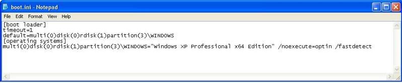

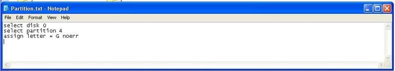

Hello Night Hawk, sorry i dont really understand what you mean exactly by browsing the boot files, ill post some pictures, tell me if im doing it wrong thanks a bunch.

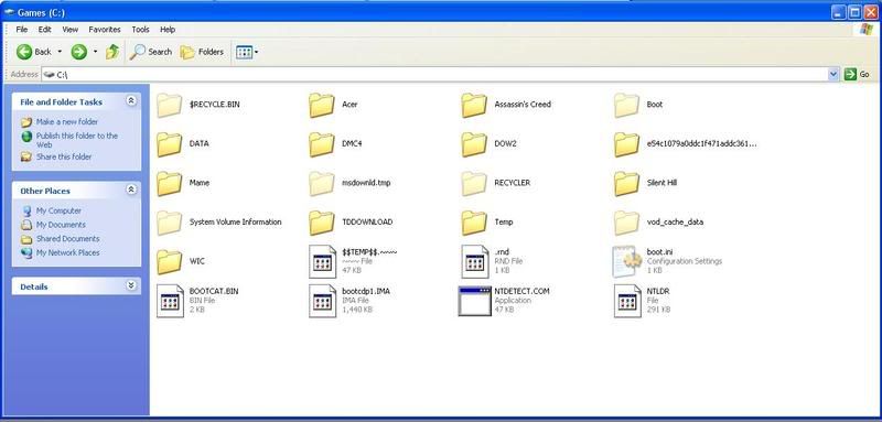

The Boot.ini is inside my Games C: Drive
This Partition.txt is inside my Vista D: Drive

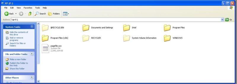

Inside my XP drive
Inside Vista Drive
and inside my Games Drive, ive placed Ntldr + NTDETECT.com inside my Games Drive so i can boot into XP, since it only recognise the C: drive as main
You have XP boot files placed by the Windows installer or by yourself on C while the Vista boot files are found on D and you are wondering why Vista won't boot?
The mbr entries on the C drive are pointing to the XP primary F to see that version load. The bios sees that drive as the default boot drive without any Vista boot information present.
Why the screenshots of both drives? That shows where the boot files are located for each version of Windows as well as how you have things setup.
Repair of the Vista boot loader isn't the problem while the boot order in the bios is since the drive XP is on is set as default. The way to see if Vista will load would be pressing the F1 key or other F key assigned for the boot device menu at post and select the drive Vista is on to see if that is bootable and Vista will load by the sound of things there.
If Vista loads right up when that drive is selected from the list then you know where the problem is. With both an ide hard drive and a sata drive present the ide will be seen as the default automatically.
Once you change the order in the bios seeing the sata drive set as the default you can edit the Vista BCD file as well as copy XP boot files over to see XP added into the Vista boot loader as an option at startup. The first thing now however is selecting the Vista drive from the boot menu to see if Vista will load on it's own being on a separate drive.

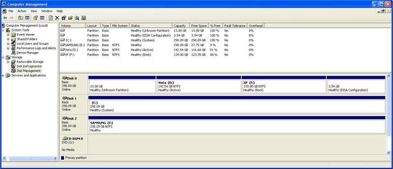

It would help if you could post a screenshot of Disk Management.
To get to Disk Management, Rt click Computer>Manage (wait a couple of secs) -in the new window that opens click Disk Management - (wait a couple of secs)

XP(HD0,3)partition is still shown on the same drive as Vista(HD0,2) there. The first partition lacks a drive letter being the recovery partition most likely. The last partition seen, HD0,4, also seems to be reserved there as well.
When Acer redid the Vista installation they weren't able to properly reconfigure the dual boot with XP you had set up originally. But the screen there shows both versions installed on the same drive not on separate hard drives.
The boot files for Vista may be on a separate drive from where the XP boot information is located explaining why you are seeing one version boot but not the other. Now you will likely need to unplug the C drive after copying the XP boot files to the Vista partition plus see the Vista boot information rewritten.
With the C set as default and only seeing the XP boot files present without traces of Vista there XP will load up if the mbr entries are also present. You would need to see the HD0 drive shown there made the default boot device where you repair install XP later if needed but see the Vista BCD rebuilt as well as seeing new mbr information.
