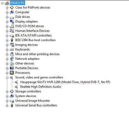

Okay, I just don't understand what you're getting at, maybe. Or maybe I'm not making myself clear. I had the HP-prescribed driver for my Realtek HD Audio installed when this started; that's the only device listed under "Sound, Video and Game Controllers". What other audio devices are you referring to? Under System Devices, I have the "High Definition Audio Controller", which is a Microsoft device, whose driver was provided by Microsoft. I don't see how it could have anything to do with the speakers--is that possible? Otherwise, I don't have any other audio devices that I know of.

Not sure about your system but I do!

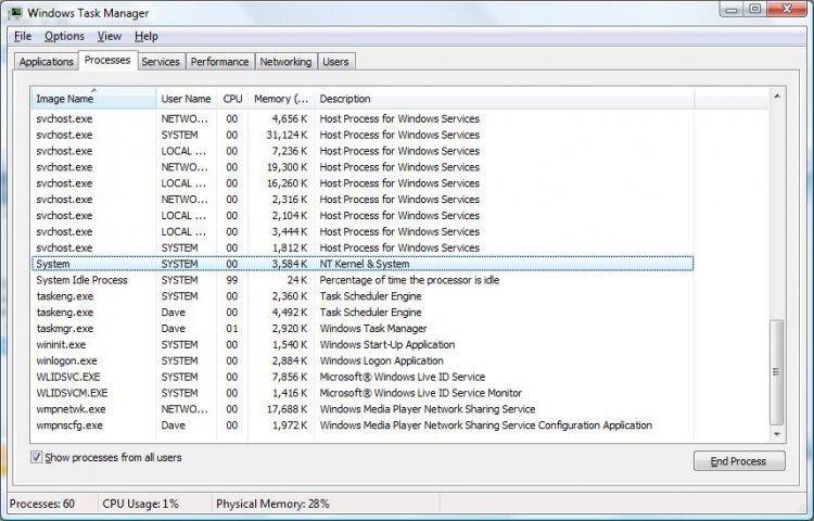

One more thing: not sure when this started, but now I have a "System" process with the description "NT Kernel & System" that is using around 50% of my CPU at all times. What the hell is that? I don't know for sure it this is related or not.
that doesnt sound good roach, i suggest a full antivirus scan, the only process that should be using your process usage up should be "system idle process", see below.

MrNeeds: after a re-start, the NT Kernel thing seems to have gone away, but the computer is running worse than ever. Windows Defender and Norton full system scans both yield a total of zero risks detected.
