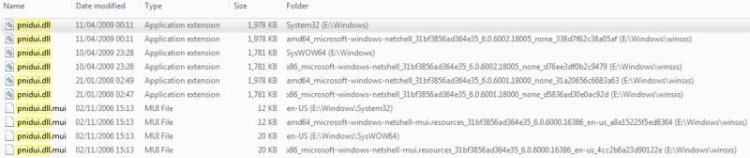

When you replaced the pnidui.dll file with a new copy, did you replace it at all locations that it is found at? Do a search for it on your entire C: drive to find all locations. You should have a few.
This shows the location of that file on my system. Note that I am writing this from Windows 7 (64-bit), so the drive location is shown as E.

Ahh, my aren't I foolish! Yes there are quite a few locations it seems along with some
pnidui.dll.mui files.
Do the Mui files need replacing as well? Where would i get those from?

No, the MUIs do not need to be replaced.

1) It seems you CANNOT simply download a dll from the internet and use it to replace faulty ones. Possible due to different versions etc. I tried it it DID NOT work.
2) I solved it by searching for all incidences of pnidui.dll. Most of them were listed as 0 bytes long. those were obv corrupt but some were like 1.93 mb long. I assumed those weren't corrupt. So i copied those into all the places were the pnidui.dlls were 0 bytes.
3) restart
Now i have the icon back :D
