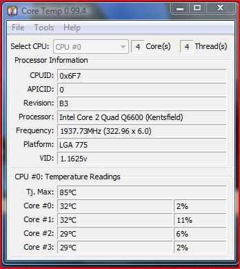

Actually there are a number of factors that can affect CPU temps, including the chip revision. Example, my Intel Core 2 Quad Q6600 (2.4GHz) "B3" revision, non-overclocked idled @52 degrees Celsius on a stock CPU cooler inside an Antec P182 case with 3 80mm fans running at medium speed. My room temp in the summer is around 70F (21c).
In the winter my room temps are around 55F (13c) and this same processor under the same case conditions ran around 37c idle!
Some people will say that’s hot, but that’s about right for this "B3 Q6600" processor! The "GO" revision runs a little cooler, I think by about 7-10 degrees Celsius lower.
Now, with a Zalman CNPS9500 AT CPU cooler this same B3 Q6600 processor overclocked to 2.9GHz idles around 30ish in the winter and around lower 40ish in the summer.
So you see… there are lots of variables to consider. My suggestion to the poster would be to check with others and see what they report for temps on his CPU and take the average. Now...Are the temps above or below that?
