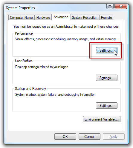

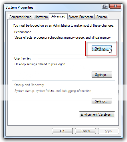

I have tried the procedure described by ALL of the above sites for disabling System Restore, but the procedure is incorrect (for my computer anyway.) I do have Windows Vista Premium, but it isn't the same as the above sites describe for this procedure. I have tried this in both regular and safe mode but the result is the same..
Click on the System and Maintenance menu option.
There is no "and Maintance" file on my computer anywhere. There is only a "System" file.
Click on System Protection in the left-hand task list.
When I do this, "System Properties" comes up.
Uncheck the checkboxes next to each hard drive listed under the Create restore points automatically on the selected disks: section. When you uncheck a disk you will be presented with the following screen...You should click on the Turn System Protection Off button.
There are no checkboxes whatsoever, there is no "restore point" option, and there is no "Turn Syste Protection off" button. The tabs are "Computer Name", "Hardware", "Advanced" and "Remote" (Advanced has "Performance", "User Profiles" and "Startup and Recovery".)
This is what it looks like:
The "System Protection" option is available only on the regular mode and I don't see how it can help, as it doesn't appear to have any of the required options.
