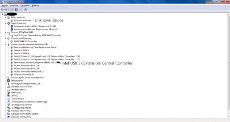

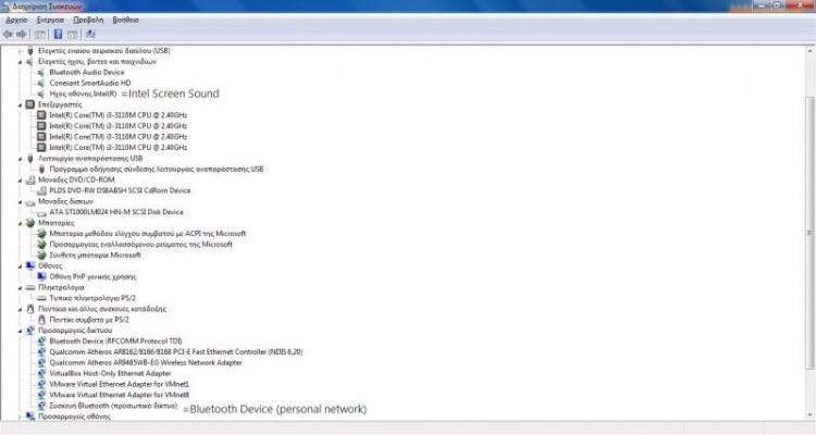

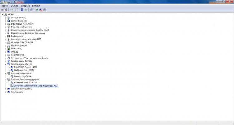

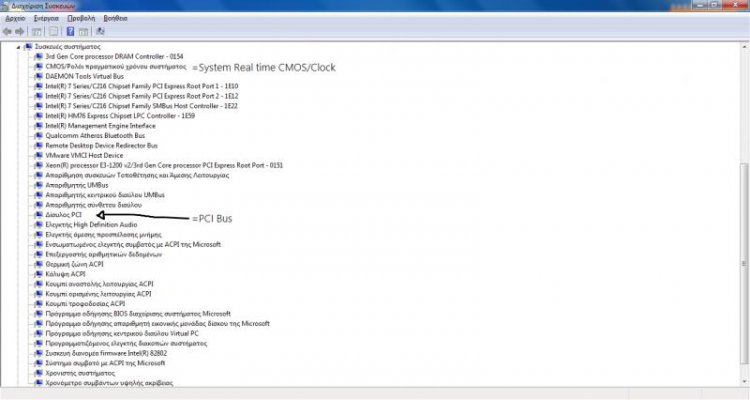

My UEFI firmware is made by InSyde.I have the latest version.Is it the problem?Windows 7 or Server 2008 R2 install without problems,just a notice about GPT not being in the recommended order.During the first reboot,does Setup load drivers other than its own?I saw this article you gave me 1-2 months ago.Compatibility mode in Windows 7 shows that the USB 3.0 driver is not compatible with Vista.
The photos are from Device Manager.Some devices are translated into English,since the computer has the Greek language installed.

I think I finally found it!
Intel HD Graphics 4000,doesn't support Vista,as seen on the Intel site.The weird thing,however,is that the driver in compatibility mode works.So,I think it's the reason the 0x0000001E BSOD occurs.The problem is that if I want to have Aero,I have to install the Intel Graphics driver,otherwise the other card,NVIDIA GeForce 610M,won't work,unless the former is installed.Tried it with Windows 7.Now,Vista 32 or 64 for VMware?Before answering,check the system details:cool:
