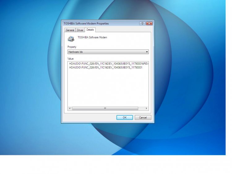

Thanks itOuchpods,

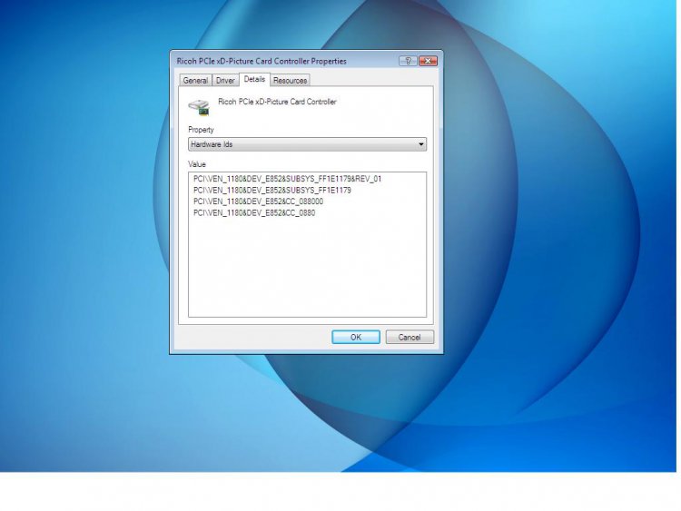

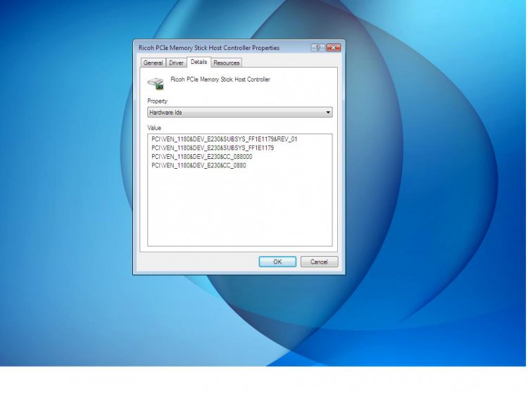

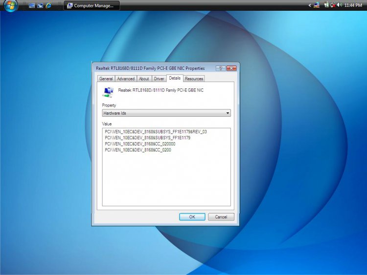

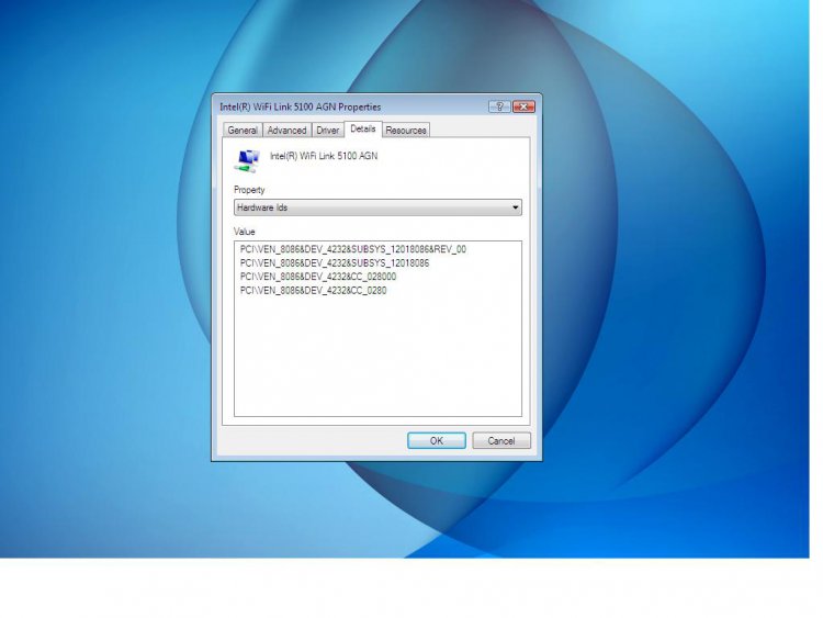

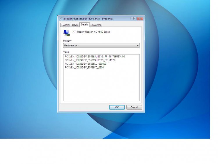

That was interesting. There is one additional missing driver that did not show up until I was working the problem on this forum. It is probably never going to be used or necessary, but if it is simple to get the driver, I would like it installed as well.
Here we go, I hope I did this right:
ATI Mobility Radeon HD 4500 Series.jpgIntel(R) WiFi Link 5100 AGN.jpgRealtck RTLB168D Family PCI-E GBE NIC.jpgRicoh PCIe Memory Stick Host Controler.jpgRicoh PCIe xD Picture Card Controller.jpgTOSHIBA Software Modem.jpg
It is quite nice to be able to handle the Screen Print function, thanks. Rather than take the time in past occasions, I found a workaround to get the info uploaded. I am ashamed to say I was so lazy. You guys are great in this forum.
I am really not so lazy, however, I get confused when reading what is a complicated instruction to me. I can no longer retain new information very long. I am able to learn still, by doing the task over and over, just like I did to get 6 images uploaded. Time will tell if it was enough to make a permanent memory. I am very old for my genetic pool by 19 years by the next oldest and 26 years by the oldest before my father. I am ageing with memory difficulties. It is one of the reasons I appreciate you guys so much. You all have been kind enough to show patience with me. I just love computing; you are making it possible for me to continue. Thanks! :geek:

Thanks itOuchpods,
View attachment 29008View attachment 29009View attachment 29010View attachment 29011View attachment 29012View attachment 29013
Hmm. I will take a look at those Ids and get new drives. I see now that some of the drivers I provided may not be the exact right one.

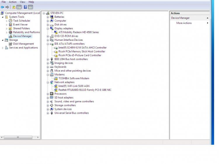

Can you provide me with a screenshot of the Device Manager itself?
1) Click Start
2) Type "devmgmt.msc"
3) Open devmgmt
4) Click Yes to User Account Control if prompted
5) Take a Screenshot of the Device Manager and please upload it here.

Items 2,3, and 4 did not provide any results; I tried them on a shell with the same result. Nevertheless, I did make a screenshot of the Device Manager. I hope it is what you expected to see. I am thinking you may have been giving me instructions for Windows7 or 8.
If what you were expecting was an image of a command line product, I tried the command line too and failed.
1) Click Start
3) Open devmgmt

The first driver was not signed and Vista refused to install it. The second was specifically for a Sony machine and warned to not use it with any other laptop. The third driver was also not recommended for installation. Thanks for trying :)
this one should be the realtck rtlb168d family pci-e Realtek <br> Sony :SVE1513G1 : Ethernet Driver (Realtek)
intel wifi link 5100 https://downloadcenter.intel.com/download/19853
try these drivers then if you get connected you can go to the manufature support site to get rest of drivers that are missing
