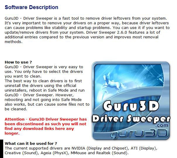

Sometimes newer drivers are problematic and the install can cause problems which is why I hardly ever update drivers and I never do so through windows update. Frequently drivers aren't completely removed by a rollback or an uninstall so if you think that's the issue then try driver sweeper: Guru3D - Driver Sweeper

There is no download link on that page. Apparently the program has been discontinued.

I just checked its still there, try again.
Hmm maybe I clicked in the wrong place.
