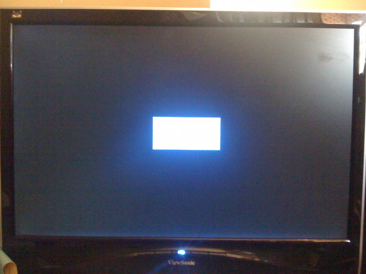

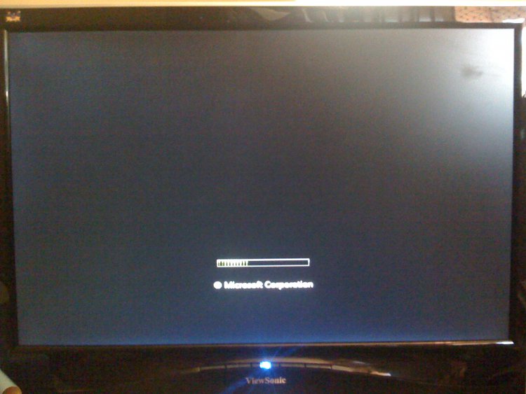

Mine says Generic Non-PnP Monitor. And yes i am installing it as "Run as an Administrator" Tried looking for updated drivers for my monitor and it says it has the best available. Still having no luck even with going to the old drivers GeForce Release 178. I'll check all the cables, but i don't think this will help seeing as it works fine in safe mode and when i uninstall the drivers it boots up fine. I'll keep trying stuff. Thanks for the imput guys

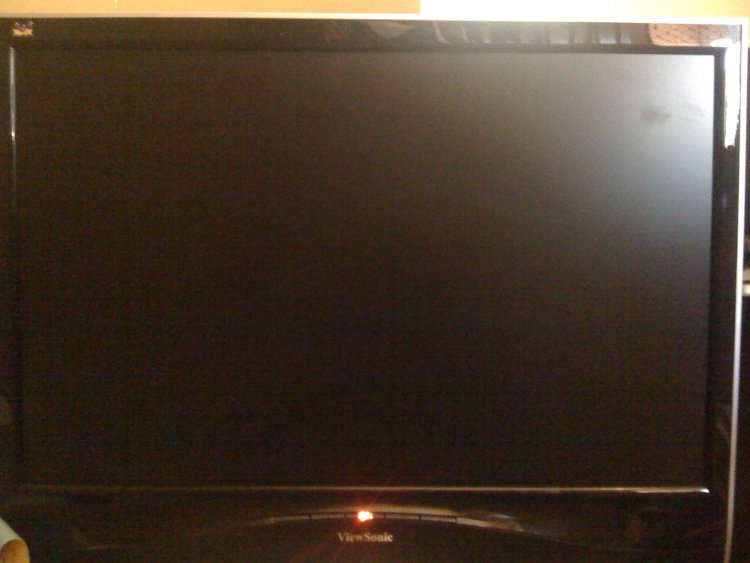

This is what i get upon rebooting after installing the Driver

Yay it's working. Right now all i did was install the lastet Vista updates (7) install driver 182.46 and it's all sweet now. So it's all good now. Thanks for everyone's advice, it was much apprecited. :cool:
