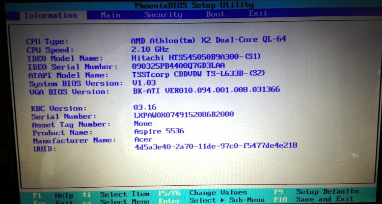

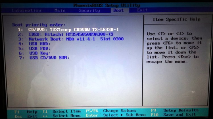

now i'm happy up to this point but the problem i have is that i try to boot to cd/dvd and cannot.
I have entered the BIOS updated the boot priority order as shown in the attached photo but with no success.

20130628_173225.jpg20130628_173218.jpg :sarc:
