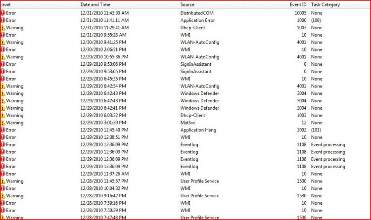

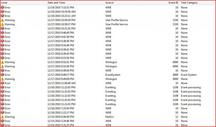

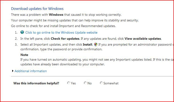

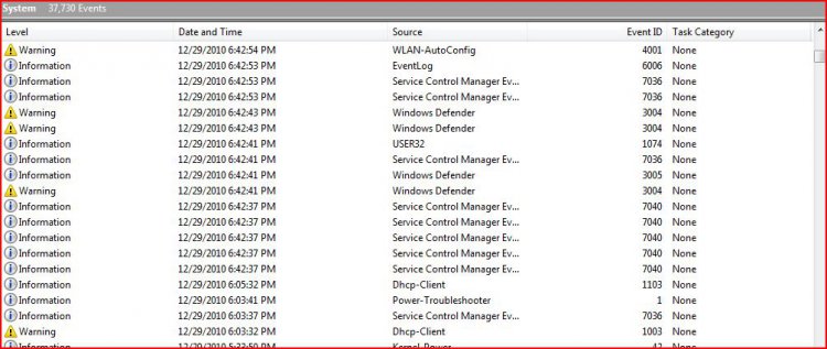

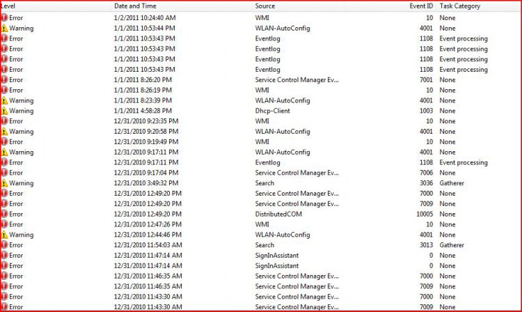

Hello I am sorry but I have also done a sfc /scannow and it said it repaired some things but was unable to repair everything, and I have done a command prompt defrag and after each one I did a reboot. I always log on to the windows mail through the the browser as with the internet. I also did a systen restore yesterday back to about a week and a half to two weeks ago and I am still have the same problem and I have not deleted anything from Kaspersky I let those items there just in case I want to do things right, I am also kind of a newbie. I bought my system from HP so all the software was already installed but I do have the factory disk's for doing a factory system recovery disks which their is 4 of them. I don't know what the 4th one is it says supplemental recovery. I made the factory recovery disks when I first got the computer and after a while I needed them and they did not burn right for some reason so I called HP and the sent me these which worked great when I used the 6 or 7 months ago. My IP provider is Cox commuications. My wifes computer has the main line and my daughter has hers set up also on the wireless and so is mine and both of theirs work fine so I know it is just my computer and I have had wireless for 3 years now. I have also went in and made sure that all my drivers are current. The chkdsk said their is no bad sectors, my event viewer has a lot of errors in yellow and red so I snipped them and saved them to my documents I will attach them to this. My mail just shut down again so I made a screeshot of it. There s more saved but i don't want to send great big files without knowing if the system will handle it.
Date: Today (8)
1/3/2011 12:14:05 PM Kaspersky Internet Security Task started IM Anti-Virus
1/3/2011 12:26:19 PM Kaspersky Internet Security Task started IM Anti-Virus
1/3/2011 12:57:30 PM Kaspersky Internet Security Task started IM Anti-Virus
1/3/2011 1:35:38 PM Kaspersky Internet Security Task started IM Anti-Virus
1/3/2011 2:21:57 PM Kaspersky Internet Security Task started IM Anti-Virus
1/3/2011 2:47:19 PM Kaspersky Internet Security Task started IM Anti-Virus
1/3/2011 2:47:35 PM Kaspersky Internet Security Unable to start tasks IM Anti-Virus Database is corrupted
1/3/2011 2:52:57 PM Kaspersky Internet Security Task started IM Anti-Virus

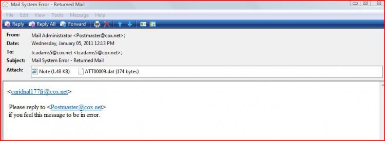

Hello again here is a little more ever time my emal acts up and it is a lot then I get it not responding. Then I recheck to make sure that the email I have is right because they belong to some friends.
