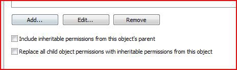

one way to ensure this is to use the advanced button on the security tab then the change permissions - at he bottom of this tab you will see two check boxes
this will allow you to automatically set permissions for the complete tree
with these permissions set you should be able to read these folders

Yes, Administrators, System & Everyone are all set for full control of this folder and all subfolders and files.
