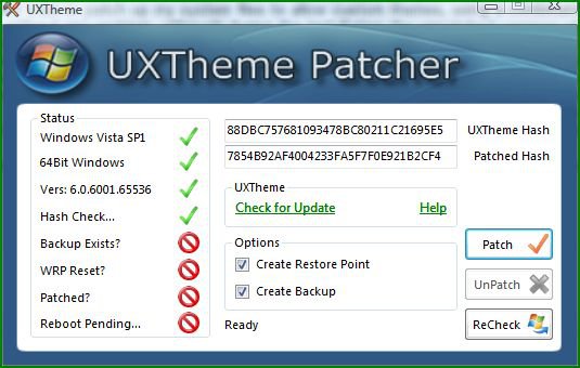

Its illegal to distribute System Files, however I will send you them anyway as I know how hard it is to recover from a failed manual attampt at uxtheme patching...Its happened to me enough times that I created a UXTheme patcher for these reasons :rolleyes:
I used 8 different file verification and system metric integrity checks before patching and I designed it to use the new Kernel Transaction Manager included with Vista and its currently the only UXTheme patcher using this functionality for 100% patching reliability, If even the slightst call fails then it doesnt touch anything, if you would like to try it out, I can send you a download link? ;)
(My system hasnt been patched since Ive mainly been using Windows 7 :p)
attachment.php
