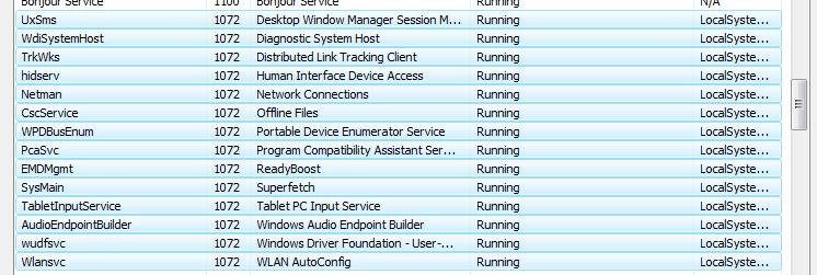

It seems that SVCHOST.exe is causing the problem and I've attached a screenshot of the associated services.
The problem seems to be random in terms of when it acts up, but quite often. The only temporary resolution is a restart.

That's not a simple issue to troubleshoot, but the good news is that it can be done.
Bear in mind that SVCHOST is a container process. Multiple "services" sometimes share the same SVCHOST instance, and the key to this situation is to first work out which service is responsible for the high processor utilisation. I assume you already know that, given your screenshot above. What might not be so obvious is how to split up the services running in the shared SVCHOST so that you eventually get to a state where there's only one service, the SVCHOST is still chewing CPU, and hence you've found the service which is the culprit.
To split a service into its own SVCHOST instance, you can run this from an (elevated) CMD prompt:
SC CONFIG <service_name> TYPE= OWN
Note the space between the equals sign and the "own". The next time that service starts, it'll be in a separate SVCHOST instance which is another process, and you've either ruled it out as the cause or you've found the culprit.
To make a service revert back to its original (shared SVCHOST) state:
SC CONFIG <service_name> TYPE= SHARE
By playing with these commands and the list of services in your screenshot, and rebooting lots and lots, you'll find the service which is responsible for high processor utilisation. There are more elegant ways to do it, but they're impractical over a web forum.
Good luck with it.

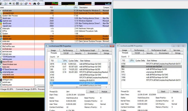

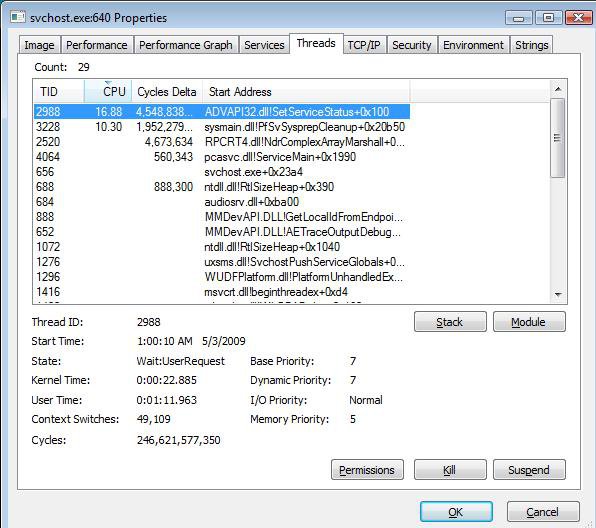

Well, see the attached picture/screenshot taken from process explorer of the bad SVChost.exe. Also, note that the process explorer process is also using about 50% of the CPU at the same time. I was able to make this problem happen twice in a row while using netflix watch instantly. Both times were after a fresh restart and the OS was fine upon restart prior to watching movie. Also, both happened after about 3 minutes of watching.
I'm not really sure what I'm looking at in process explorer, especially when I look at the process explorer details. Currently task manager and the scv host process are using 40-50% each. I'm going to restart now.
I can't pinpoint anything....
Thanks...
