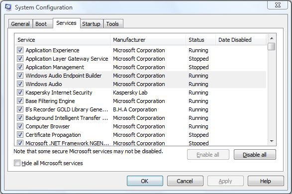

I'm a bit of a luddite but i've been trying to get less services to start when i start my computer and thus Vista, and have inadvertantly now turned off my audio services (remarkably, even after turning off loads of other things, this seems to be the only thing that has changed). I can't tell from my active services list (after doing msconfig) which one is affecting my audio. I've made sure the obvious ones are still ticked, of course.
Is there anyone who could give me an idea of which one should be ticked in order for the audio service to come back on? I'm loathe to start them all back up again to try and find out...
Have you ensured that the highlighted services (Windows Audio Endpoint Builder and Windows Audio) are enabled?
In addition, check that the following services are also enabled: Multimedia Class Scheduler, Remote Procedure Call (RPC), DCOM Server Process Launcher, Plug and Play.
Follow the instructions in this Tutorial: http://www.vistax64.com/tutorials/59910-services.html and set all of the above services to Automatic.

Have you checked the extra instructions at the end of my post? It seems that I was adding these whilst you were replying. For detailed instructions on which services to disable and which to leave enabled, see the relevant Black Viper page (link given in the Tutorial).
