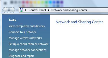

It sounds as thought the "Connect to a network" function in Network & sharing Center has not been run or was stopped half way?
Please run this, on your PC & ensure the settings are correct, as it should sort out the issue.
