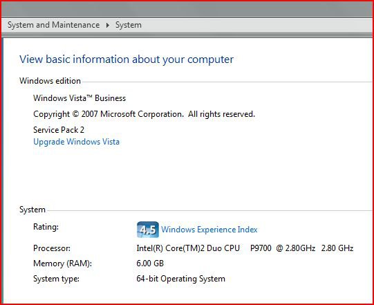

What do you see in the system properties window:

If you have really SP1 installed and this error appear this means corruption or CBS key or in C:\Windows\Servicing\Packages folder.

When you go into the system menu it shows that i Have Vista service pack 1 installed.
