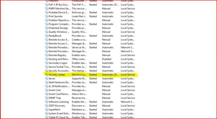

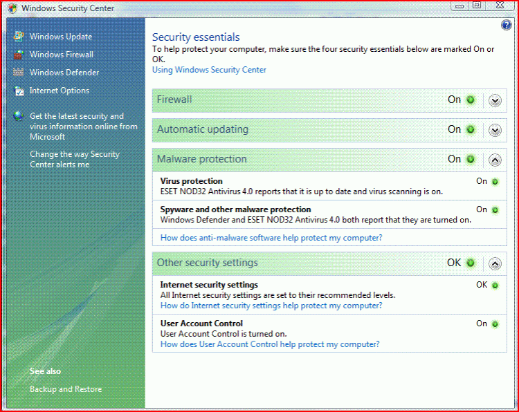

NOD32 has spyware protection, and I also run Windows Defender with my NOD32 3.0 (now 4.0) installation. I am not seeing any of the issues you or the other OP are having, which leads me to believe that there is a conflict and/or corruption due to programs that were installed, or must likely, through User error.
If you are running other antispyware/antimalware programs, remove them. NOD32 and Defender run well together without Vista conflicts. You can try removing any installed programs, updating NOD32, and see if the problem resolves itself. Do not disable UAC on your system!
