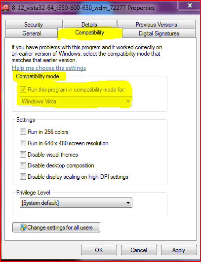

right click on the downloaded software (drivers) then click properties and you will see compatibility mode . it looks like this .
under the ( run this program in compatibility mode for) use xp sp2

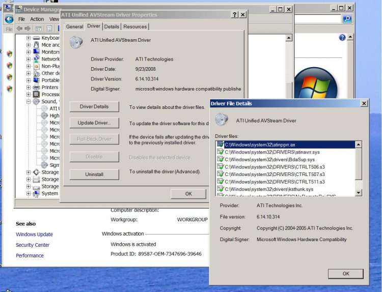

I pulled the card and checked the device manager. Yes, the hidden files view shows a ghost installation. From within the driver tab, I found and attach herewith a screen shot showing "driver details." What is this?
It appears to be a list of 9 directory locations where the old driver is stored. Are these multiple copies? Different components? If I simply uninstall this (old) driver, will it be erased from all these different locations?
Or should I go in after them one by one?
An UPDATE. I looked through these files. The are variously dated. One is from last September, but a couple are from early this month. It appears the whole collection was installed from the most current (Dec 10) download.
I ran the driver uninstall, and then went in an systematically deleted all the installation and other files. As I was doing this, I noticed the computer was becoming happier and faster.
