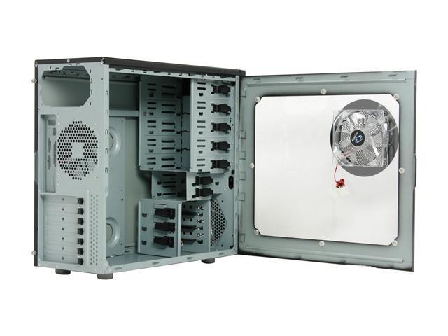

I was going to install a front 120mm fan but I cant figure out how to get it to bolt on. Do I just let it sit there? Can I take the front cover off?
If you need to know more let me know....

Looking at the picture of the case on Newegg, it looks like it bolts right there between the front of the case and the HD cage. You'd have to take the front of the case off and run the screws through the front metal into the fan (make sure the fan is oriented correctly):
The case should have come with instructions, but I think most of those type cases the front is just held on by tabs, not screws. But you don't have to leave the front of the case off, if that's what you mean it should have airflow to the fan.

I found the tabs that hold the front on. And I will propably try and snip off the metal next weekend.
