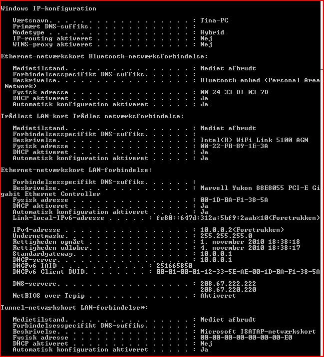

Could you click Start>All Programs>Accessories
once in that Folder could you right click Command Prompt and Click Run as Administrator
After that Type this in:
Code:
ipconfig /all

Ooops Sorry I forgot to add could you Please Post me What It says or Upload a Snip by using the Snipping tool
Go to Start>Accessories>Snipping Tool
And Drag accross the Command Prompt and then Upload it into your Next Post
This information for me to help you not a Solution yet ;)

Are you able to get an English Translation for this when you do I will be able to Help you further

Are any other devices or computers connected wirelessly and are they working fine or is this the only computer with a wireless connection?

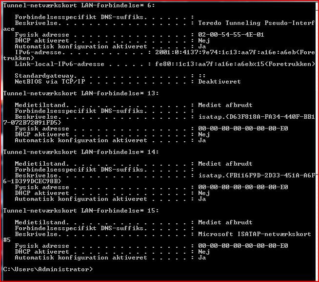

Do you have a separate connection when working wireless (this looks to be the ethernet cable connection but I'm guessing as I don't speak German? either). If so, try to connect using the wireless connection (which should be different) and send another screenshot showing info about that connection (even if it doesn't work) so we can see if and how it differs from the one used to connect by cable.
Even though I can't read or understand everything, I have a good idea of where things are located on this report and can guess at most of the settings - so don't worry about the translation for the moment.

I realize you can't connect, but if you try with the wireless connection option ipconfig /all will provide details about the wireless connection and that may help (or it may all be blank and then we'll have to try something else).
So we have no way to test if the router is transmitting a signal since this is the only device that's connected to it wirelessly (excluding the other computer which it sounds like you have setup to use this computer's connection rather than directly). Are these two computers connected together by cable or by a local wireless connection through the router? Are they networked together to talk to each other and share files or printers or anything? If so, can you do that (even if you can't get on the internet)? That might mean the router is transmitting a signal and would verify that the wireless cards are working in both computers - thus ruling out some problems we won't need to consider.
If this doesn't reveal anything useful, the next logical step would be to add a new wireless connection to the computer as if you were starting from scratch (with the proper settings) and see if that one works.
