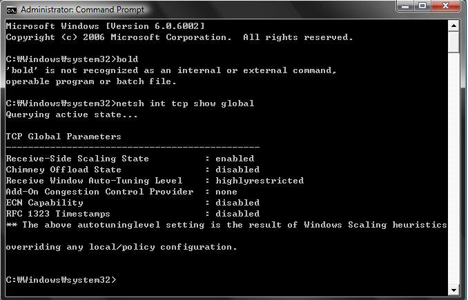

I checked some tips how to speed up my laptop's performance
I saw "how to Enable or Disable the Receive Window Auto Tuning Level in Vista"
and I saw that the auto tuning was highly restricted (see the attachment). Does this prevent the internet go slow? cause i'm having problems where I can't load some videos fast.

You did not provide the attachment for the auto tuning, as stated in your post.

and if you know anything about the auto tuning level
plz help. If it prevents smooth game play I want to fix it :D
