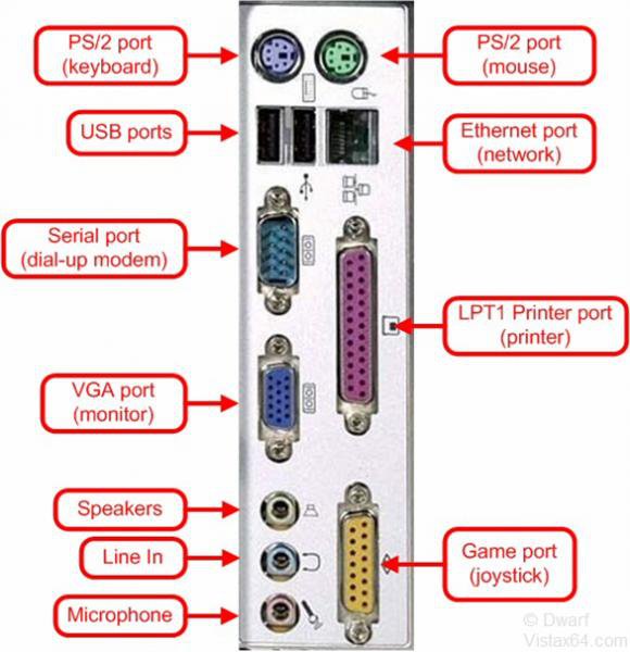

too be honest i don,t know if it has a parallel port,i went into event viewer to check on something else because i,m having that many problems and came across it.
On the back of your system, do you have a port looking like this? It's the LPT1 Printer Port.

Most of the newer machines use USB ports instead for printer. Is your Vista SP1 SP2 or before any service pack?

its possible that you do the have port onboard but not have the extension socket connected, some boards even have only the solder joints marked but still have the port option enabled in bios. check the bios and see if this option is enabled, if it is disable save and reboot.
