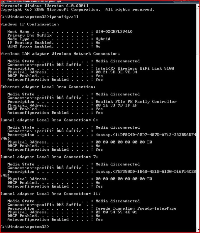

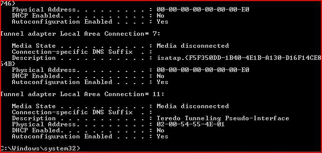

i have tried step 3 with no luck, i dont have the manufacturer router information, because my friend went to mexico for a trip y this is the key he gave if901195e6. my another laptop running windows 7 connects just fine. but this windows vista wont ask for the key
Hi cowsquad,
I need the upper part of IPCONFIG/ALL as well (all of it). You just provided the ending which doesn't contain anything useful. It may take 2 or 3 shots to get the entire thing.
What went wrong with step 3? Did you get an error message (if so, what word-for-word)? Is it that you don't understand the procedure - if so, please explain where you don't understand and I'll try to provide a more detailed description.

Hi cowsquad,
According to IPCONFIG/ALL the Wireless Adapter is showing as diconnected for this connection. That explains why it doesn't work. But I don't understand why it is showing as disconnected for this connection but seems to be working for the other connections. Something is messed up with this connection setup.
I recommend you go to the W7 computer that connects to this network and open up all the information about the connection. Then go to the Vista computer that doesn't connect and create a whole new wireless connections with exactly the same settings as are on the W7 computer. Be sure to check ALL the settings as we don't know where the error exists. I believe they are similar enough that you'll be able to duplicate it exactly. Then delete the old connection and reboot. Then try and connect again with the new connection. If it fails again, do another IPCONFIG/ALL and see if the wireless card shows information or says it is still disconnected.

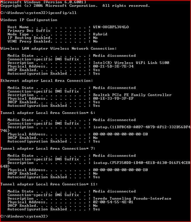

didnt work i keep getting the sama error. there is my new ipconfig/all
