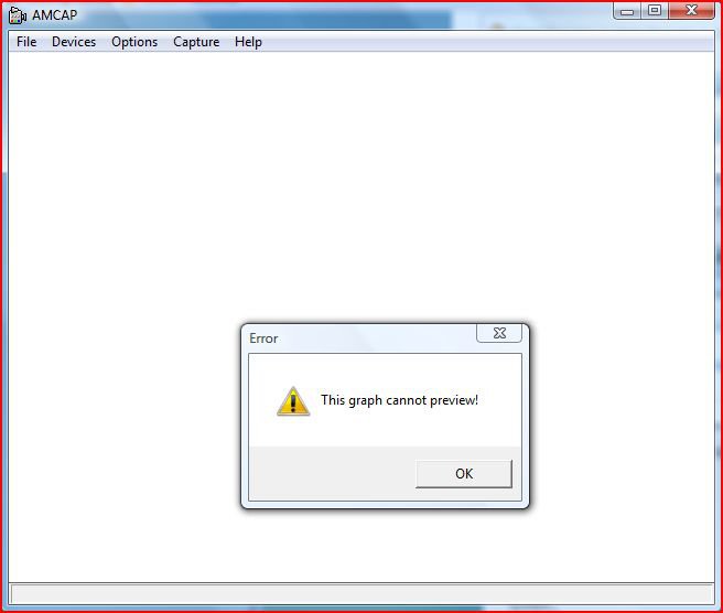

i have a creative webcam that will not work with vista, so after using it with XP, i got sick of having it on my hard drive, so i bought a cheap camera so i can use webcam on vista, unfortunately, when i came to install it, the camera installed but kept getting a code 10 driver could not load. So after a few trolling sessions to find a resolution, i found i had to edit a key in the registry, in this case : HKEY_LOCAL_MACHINE\SYSTEM\CurrentControlSet\Control\Class\{6BDD1FC6-810F-11D0-BEC7-08002BE2092F} and delete the upper and lower values to allow driver load. after a restart, everything looked good, my camera is now loading up and drivers are working
camera1.jpg, but everytime i try and use it, i get this
any solutions?

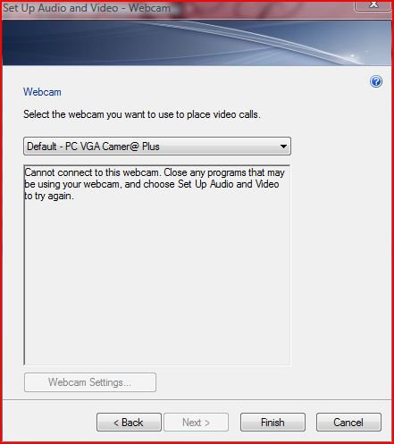

It isn't working :'( im getting the same "this graph cannot preview" again, and i also tried it on windows live to see if it was the amcap software

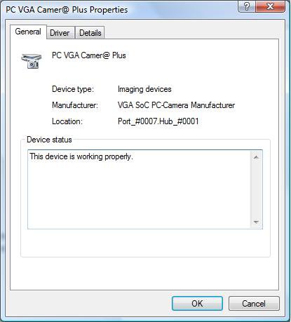

which will work on vista x32 but refuses point blank to work on vista x64, this camera is a technika H16WC-01
which shows up as PC VGA Camer@ Plus on windows vista, the camera does work on windows 7 x64 and xp x32 but not my version of vista, i know that if i plug any camera in, i will get the same errors, my TV card did the same thing when i tried to install the old creative, no picture, i think i may need a repair install of vista to fix this issue, thats why i came to the conclusion that i needed a key for the registry as it only affects imaging devices.

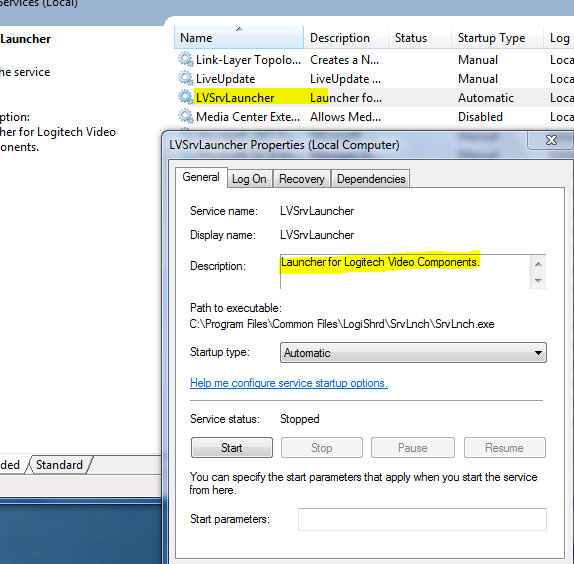

Check that the logiteck webcam service is exists.

yes, it does exist, but i dont want a logitech service on my system, its the main reason that it doesnt work, ive tried a few things yesterday including reinstalling logitech drivers because i heard that a newer version of logitech drivers fixes imaging devices.

i had a logitech quickcam which doesnt have any vista drivers for it, so i tried to use xp drivers to get it to work, before i used to watch tv on my vista install on media center, after i installed logitech drivers, the cam didnt work or install, and my tv card stopped working (by stopped working i mean it was installed but no signal was being detected), so i thought nothing of it and bought a new camera, this is the technika camera im using now, this installs and windows reports it as working, but as soon as i open up amcap, it says "cannot preview graph", and when i try to use it on any other software, it says that the camera is in use by another person or program (which its not). the same thing happens to my tv card, no picture or signal is being recieved, tried a friends scanner and it doesnt work either, saying that its been detected but its being used by another person or program, im at my wits end.
