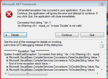

hi, i keep getting this popup box on the screen and i dont know what its about, also if i scroll down the pop up box it gives me the option,when JIT debugging is enabled, any unhandled exception will be sent to the JIT debugger registered on the computer rather than handled by this dialog box, as i am a newbie i am always afraid to change anything if i dont know what its about. i have windows vista premium 32-bit thank you.patch41

In plain(er) English:
"This application is about to crash because of an invalid attempt to convert a type of data to something which is incompatible. Since the app itself did not provide any means of recovering from this predicament, a crash is now inevitable. If you coded this application, or if you simply feel like delving into its code and you know what you're doing, feel free to have a go at just-in-time (JIT) debugging of this app. Otherwise, if you click 'Quit', the app will simply close and terminate at this point."
The app happens to rely on Visual Basic.Net, but that's not particularly important in this situation. It's apparently some sort of front-end for a mySql database, if that helps to narrow it down.
The key is to work out which app is crashing and then to update it to the latest available version. If the same crash still occurs, you might want to contact the app developer and to send them the same screenshot.
EDIT: It's possible the data which is being worked on is itself somehow mangled, but strictly speaking the fact that the app cannot seem to deal with that gracefully is still a bug in the app. If you know what data the app is currently working with, and if you can purge that data, you may be able to get back to a clean and functional starting point.

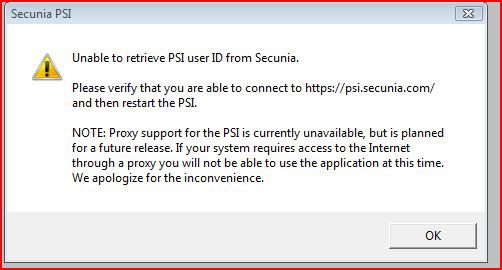

hi, i do keep getting a popup box from secunia.org which is a freeware program could this be the culprit, and if so do i get in with secunia to solve the problem

Well it could be anything (written as a .Net app), including possibly the freeware you mentioned. However, unless there's a clear correlation between the times when you use the freeware app and the .Net crash message, or perhaps even between the two errors you described, I'd recommend against jumping to the conclusion that secunia.org is definitely behind your woes.
Instead, if you can copy the full text of that .Net error report - everything in that scroll box - and attach it here as a text file or just paste the text, I or someone else may be able to pinpoint the exact app.
You may also want to check the system and application event logs (run EVENTVWR) for any obvious errors which point to a specific app crashing just after you see that .Net popup.
Lastly, try running WERCON and checking whether any of the app crashes recorded there (click the 'history' link on the left) always match the times of the .Net popup.
