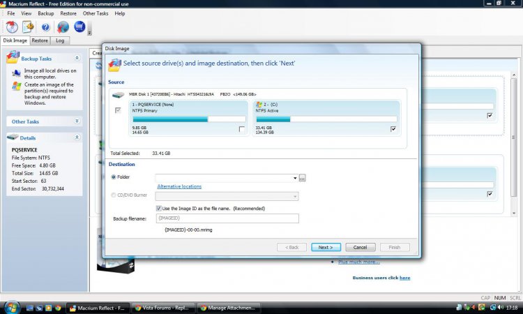

also i have a hidden eisa partition. would i need to copy that also or is that non essential to windows os?

as for the eisa partition must i copy/image that also or just the windows partition? see inc screen..

You would not need the EISA partition if you use Macrium. EISA partition is a method to get back to the way the computer was the day you took it home. Why get involved with Factory settings and do all the updates, installs, etc again, if you have an up to date Macrium.
What I would do if I were you, be sure that you understand Macrium and test it before deleting anything.
