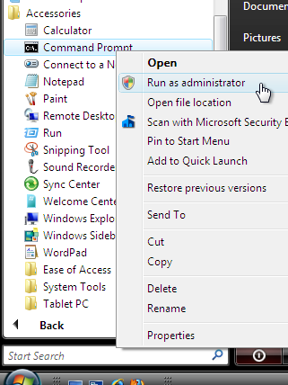

To use the command prompt, open an elevated command prompt like this:
With the network cable connected to you Vista computer, first type this:
ipconfig /flushdns
Then:
ipconfig /all release
ipconfig /all renew
It will take a minute or so, so don't be in a rush, but this should allow Vista to connect to the router again with a new connection.

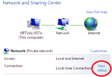

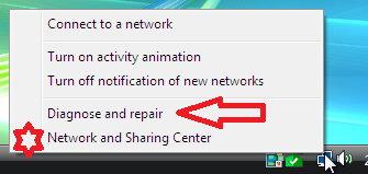

You can also have Vista do most of this for you. The icon at the bottom right will open a menu to diagnose your connections, and to open the "Network and Sharing Center".
From there you can view and repair your local area connection.

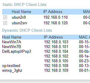

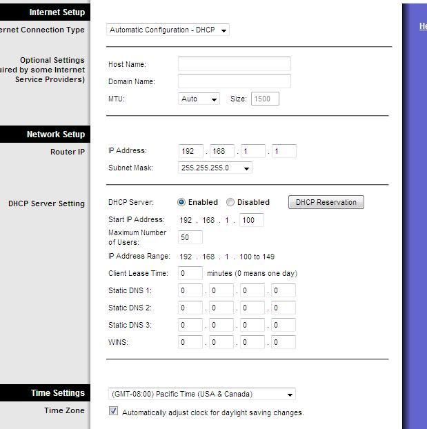

OK Lets look at this ... connect back up to the router with the network cable and open the router's settings menu. Find the page with DHCP and capture a screen shot for me. I would like to see what address is being assigned to your computer by the router?
Example:
I can't access it. It's timing out on me. Awesome. :cry:

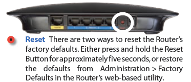

OK there are a couple things to try ... one is to reset the modem:
Also, I would suggest power off the modem, power off the computer ... then power on the modem, and power on the computer, in that order. In other words, power up the modem first, wait for it to boot up completely, then power up the computer connected via network cable.
