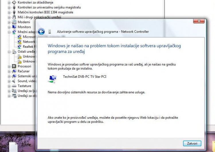

I inserted a Sky star 2 PCI card and windows is registering it and starts the driver install process but then this happens :
"windows found driver software for your device but encountered an error while attempting to install it
Insufficient system resources exist to complete the requested service"
The card is fully functional I tested it. HELPPPPPP
I run Vista Ultimate 64 bit Q9550 4GB ram 1 TB hard .

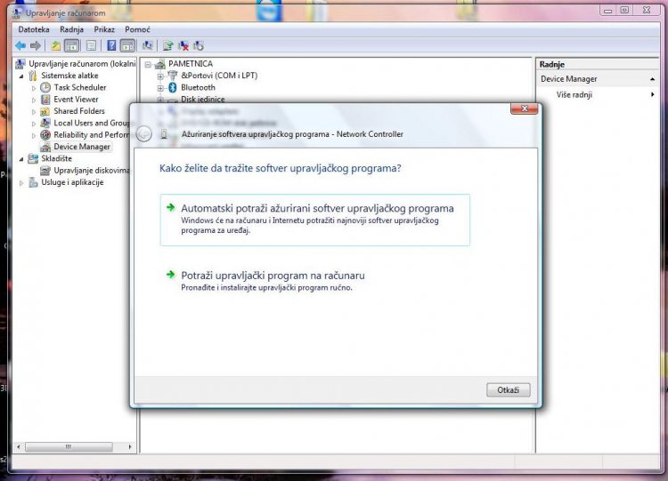

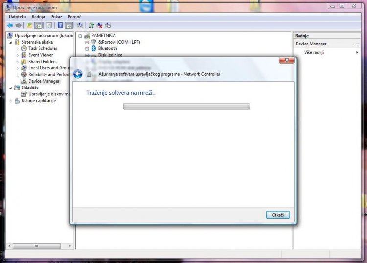

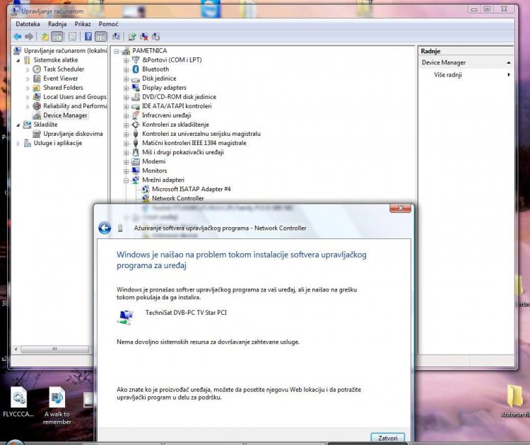

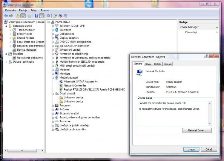

Here watch the pictures :
Sorry because my windows is in Serbian

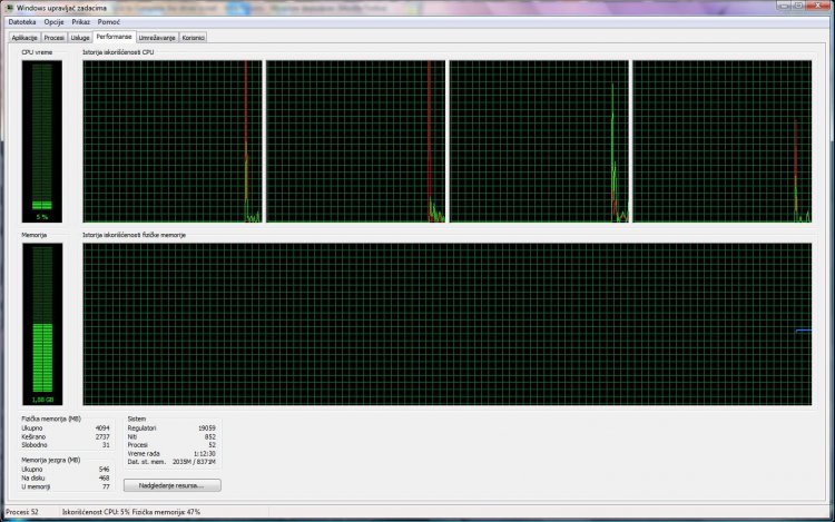

Go to task bar right click, bring up task manager, what does it show under performance. Free and availble memory?
You have more than half availble
But
Only about 31 mb free. I think that might be the problem. What is using all the ram?
Give me a screen shot of task manager process.
