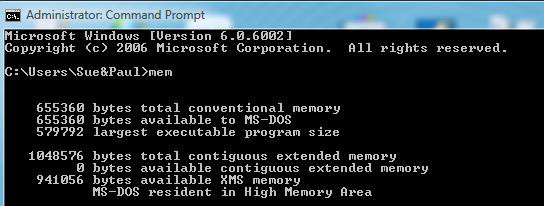

What programs are you trying to run and how old are they? How large are they? Have you run virus and malware scans?

Open a DOS prompt & post the memory config when: -
mem
is typed in to the command screen

Found this & it might help with the problem?
From posts in this thread: - Expanded Memory in Vista for DOS Applications
You can change these settings by running explorer as Administrator or you can also change it from Safe Mode. To run explorer as Administrator, open up a new elevated command window by right clicking cmd.exe -> Run as administrator, then open Task Manager and End Process on explorer, then from the elevated command prompt type explorer.exe (DO NOT EXIT TASK MANGER). Explorer is now running elevated, navigate to C:\WINDOWS\System32\command.com and right click -> properties, proceed to change the setting in the memory tab. After you are completed to return explorer to a standard user process context goto task manager and end the explorer process, then goto File->New Task(Run...) and type explorer.exe, explorer is now running in a standard user process.
