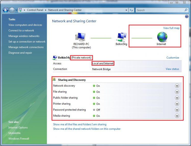

  • Click Start then Network
  • In the top of Network, click Network and Sharing Center
  • Make sure the settings I have circled are exactly the same as mine. If you want password protected sharing, turn it off for now, just to see if we can get it to work. (Click on image to see a larger version of the picture)

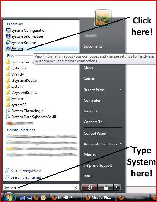

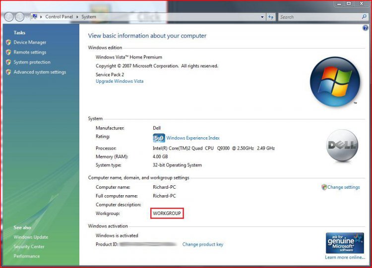

Now, if the problem still remains, click Start and in the Search box type "System". Wait for the results to load, and click on "System"
Now make sure that the Workgroup value is the same on both computers (it does not matter if it is different from mine, just make sure they are both the same)
