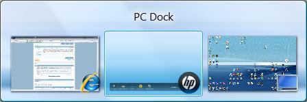

Are you using the keyboard to control the game? Do you press Alt Tab at all? As this will change the focus.
Do you see something like this first?
