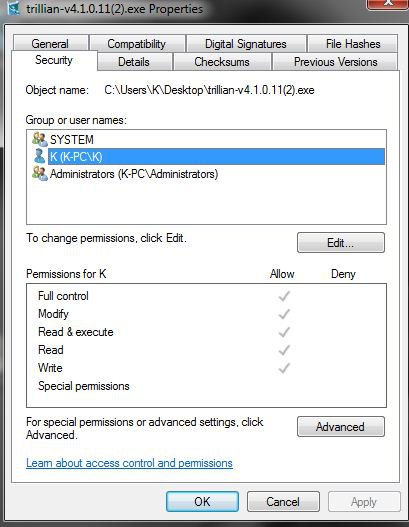

checking permissions is easy. go to the file (in this case the flex file that launches the app) and right click it. go to properties and then go to the security tab. highlight your user name and look at what boxes are checked. you should have all the boxes checked for your user name. that gives you all the rights.
see the pic

I checked permissions and I have everything except special permissions in both Owner and Administrator. It won't let me check the special permissions for either. The only thing I did was download a zip file, open it and then tried to run the setup executable...
