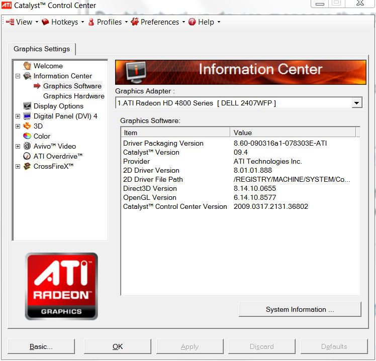

Double check in device manager that the cat 9.4 drivers are actually installed. They should show as 8.60. Cat 9.4 has an installation issue.
If they are 8.59 or lower you'll need to manually install the driver.
In device manager, Expand Display adapter, right-click on the device>update driver software>List devices on this computer>have disk and point it to:
C:\ATI\Support\9-4_vista64_win7_64_dd_ccc_wdm_enu\Driver\Packages\Drivers\Display\LH_INF\CH_78303.inf
Once the drivers are installed open Catalyst Control Center and verify that both the Cat version and the drivers are from 9.4:

Thanx for the detailed walkthrough guys but both catalyst version and driver version are as you said. 8.6 and 9.4... Hmm Could it maybe be a problem lying somewhere else that is causing this driver to malfunction? Ie a dodgy windows copy or something along those lines? Cant wait to test this graphics card out with a couple games. Ive heard only good things about it so far and hopefully the error only lies with boot up!

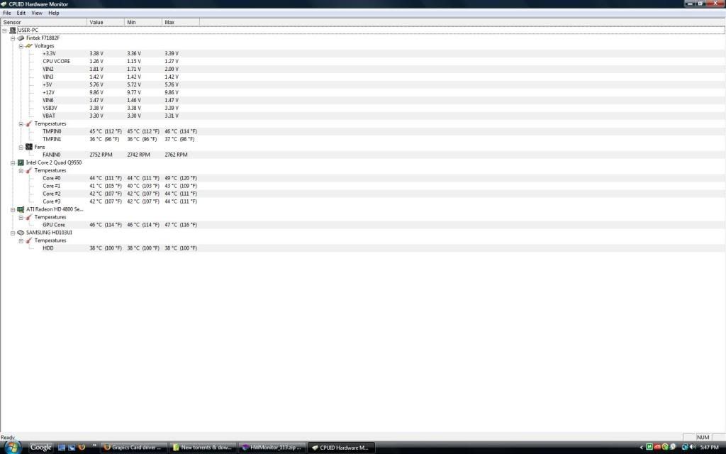

Also make sure and do everyhing in my sig as this will reduce compatability errors and optimize whats there. Then download http://www.cpuid.com/hwmonitor.php , run it then fully open it and take a screenshot and post it here so we can see your voltages, temps etc
Ok ive done all those downloads in your sig and checked the device manager with no obvious errors. Here is my comp status:
To me it looks like your power supply is at fault as your 12v readings are coming back as under 10v. What power supply are you using?
