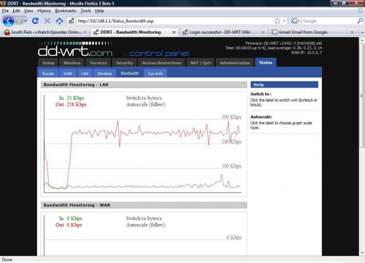

A really good wireless router would be the WRT54GL since they are cheap ($50 US), easy to use and have software comparable to commercial access points.
Once you update it with Firmware like DD-WRT it adds heaps of features worth thousands of dollars...It even lets you increase the wireless output voltage for better signal quality.
DD-WRT is free for everyone and works with other routers too but the WRT54GL is the easiest by far...
Its very easy to setup once you have DDWRT installed, There is a simple 3 step guide you must follow so you dont brick the router... So when you get one I will save you lots of time and help you install it.
Steven
where can I install this DD-WRT? you mean install into the pc will enhance the signal strength ?
