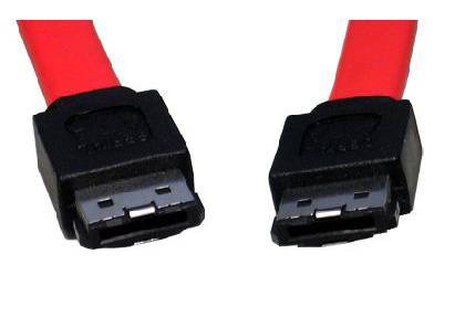

hi guys would this be the kind of lead im looking for?

Using eSATA would be faster.
The cable connection for the acer aspire R3600 would need to have a connection like the screenshot you posted.
The cable connection for the HDD would really depend one if you have the WD500GB in external HDD enclosure, or you just connecting directly yo the bare HDD.
If you're using a HDD enclosure, then you have posted the correct eSATA cable you needed.

thanks thats brilliant. i will endevour to purchase the correct lead in order to make use of this.
ok thats what i thought as the port on the revo is (female) and the lead is male
the wd500GB is in a non branded HDD enclosure. however the connection looks similar to on the revo and has eSATA pirnted underneath the port as does the acer.
ok brilliant i will get on and purchase one thanks.
